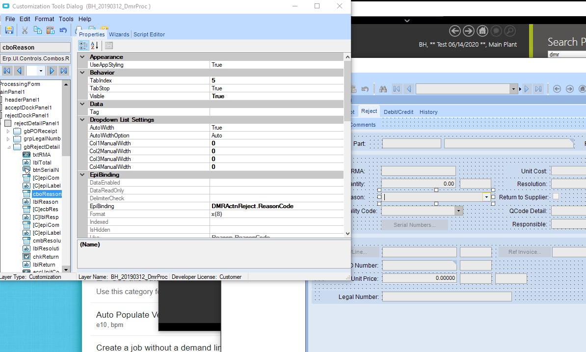

Attempting to make a UI Customization of DMR Processing, and need to react “before field change” or “after field change” according to DMRActnReject.ReasonCode, shown here.

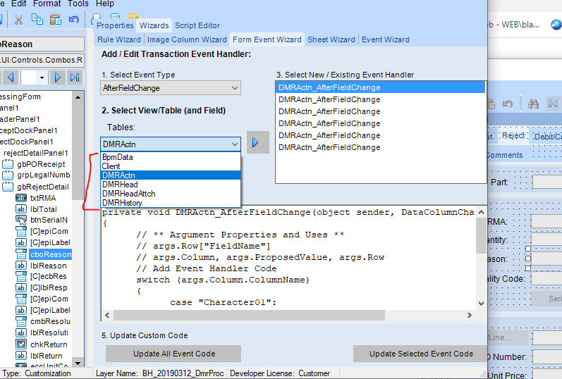

Unfortunately the table can’t be selected in the table dropdown list in Form Event Wizard.
Are there any of the wizards or Data Tools I can use, to make it available?

Just use a different table to generate the code and update the code manually, see if it works.
DMRActnReject is EpiDataView. But the table it uses is actually DMRActn with a filter of ActionType = ‘R’
So simply use DMRActn and it should trigger still for your field.

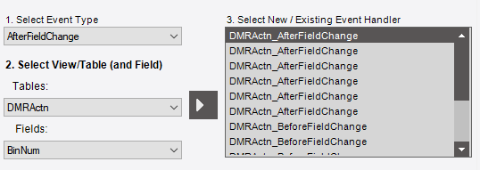

I have not, one thing that also strikes me if you add it and come back the wizard code shows the method duplicated many times.
It looks like the form itself has that many ColumnChange events and it thinks they are yours “Customized” and I think one of the events is probably stopping the others with something like args.Handled or args.Cancelled.

Thank you for these ideas. When I start with Base code, and only do Before Field Change or After Field Change on the ReasonCode field in 10.2.300.9, I do NOT see all those duplications in the event handler list, only my own. But I do not get triggered in either case, so I’m not able to take the custom action needed.
