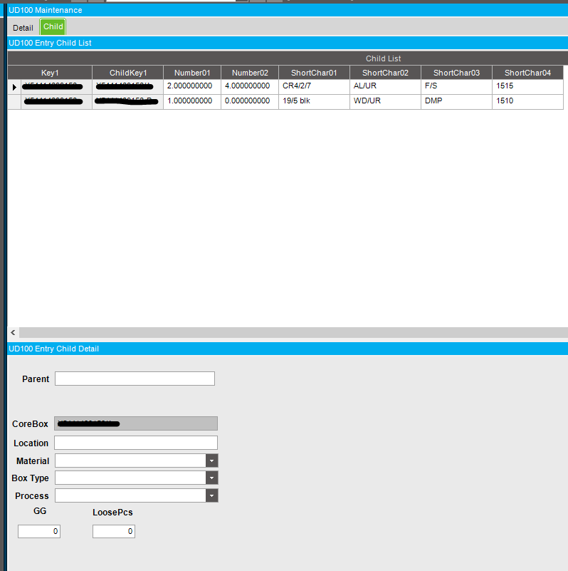

I’m trying to utilize UD100 and UD100A to store tooling information. Tooling is the parent (UD100) and would eventually tie to a part number in Part. The tooling has children (UD100A)
I’ve setup & designed the UD100 table and am now trying to make the UD100A table work. In List view I can see the data but on the form view it doesn’t seem to be populating. The ChildKey1 is on the form, but none of the other data.
I brought all my data in with a DMT from an access database. Did I miss something that’s not allowing the data to show in the form view?
