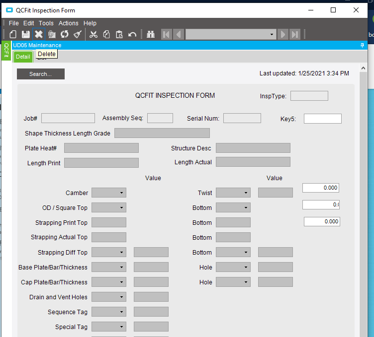

UD05 Custom Form Blanks after oTrans.GetNew
I need some guidance to figure out why this custom form blanks after executing the UD05Form_Load code.

I removed the LFO and BAQ lookup logic and hard coded some key values and this generally works as expected:
  1. Initial Form Open: New UD05 row is created w/o issue
  2. Close and Reopen Form: Existing UD05 row is loaded w/o issue
Are you handling any other events?
The only other thing i did was to set the combo boxes Property RetrieveOnActivate to False and loaded EpiStaticDataList

What happens if you comment out the entire section involving the DynamicQueryAdapter?
Can you attach Visual Studio?
Do you mean am i using Visual Studio to debug? Yes
Tested Commenting out the DynamicQueryAdapter and hard coded the values that load to
neTempPrintLength.Value = 1111.11;
nePrintTopStrap.Value = 8888.88;
nePrintBotStrap.Value = 9999.99;
Same result Form blanks after briefly displaying values.
Do you want to see all the code from Visual Studio?
Do you have any method or data directives on UD05?
Nope it is a “virgin” table used for just for this application.
Just an update for a work around that we tried. We put a button on the form to perform the event that we attempted in the Form_Load and were successful at creating a new record and retrieving an exisiting record from UD05.
This does create another “click” that will need to happen. Does anyone know of an “after” form_load method we can use? We can’t seem to find one.
