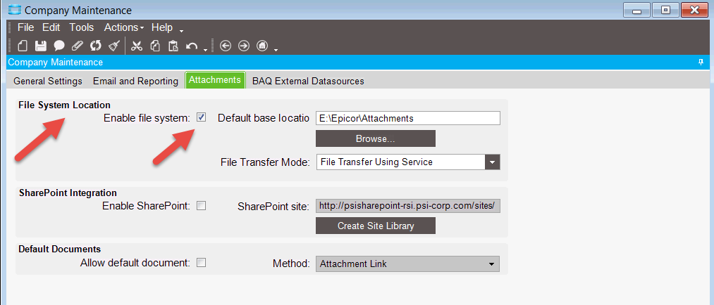

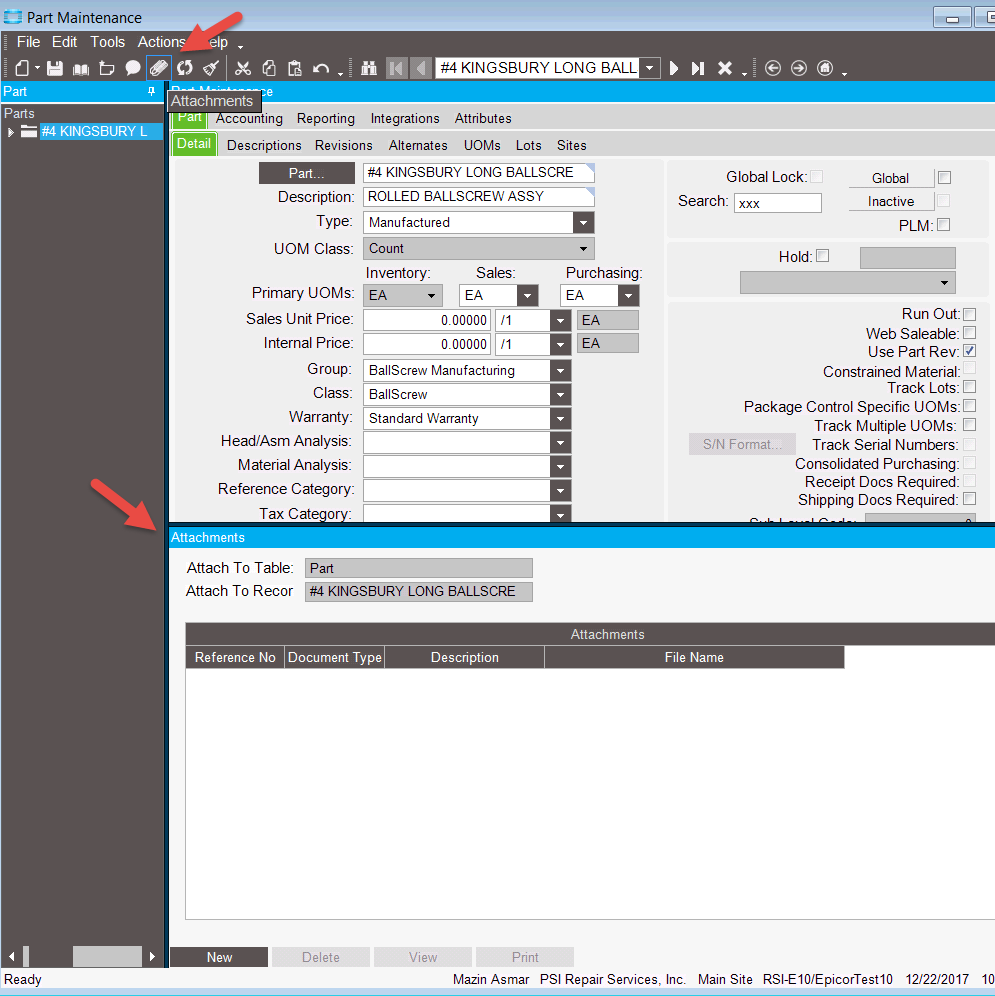

You can store all attachments on the server file system within a dedicated shared sub-folder(s). Epicor Document Management product will do this and will create a sub-folder for each DB header table. You don’t need the DocStar Enterprise Content Management product. In E10 online help, see document management and document type. You will need to work with your DBA or APP admin to create the root shared folder. You will also need to define the repository method under company maintenance. You can use the File System Location method.
Thanks for the idea. This business case doesn’t use attachments at this time. This might be useful if we want to store the document of record to the UD_Cert table in the future.
