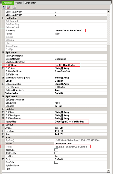

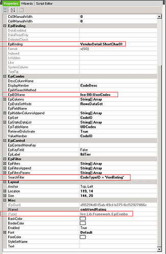

I do have access to EpicCare but not epic web. I will check for those guides, thank you for the suggestion and for the rest of all your (and others) help !! One last question, I created the user codes as suggested with all my custom fields but when I go into extended properties for UD01 I cant link those codes to the columns. The UD code type drop down doesnt have any data. Do I have to customize the form for UD01 first and add the codes adapter view to it ?
If you add an EpiCombo, then you should be able to search for the EpiBOName “Ice:BO:UserCodes”
then in SearchFilter specify you (User) CodeTypeID
and then Epibinding to the field you want.
Here is an example of a combo setting sheet from a custom Supplier entry form
