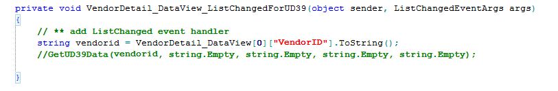

I have a UD Table setup as a child to Supplier Maintenance. I am trying to use it to enter new data records using the VendorID as Key1 and the wizard generated auto-incrementing counter as Key5. I have two date fields and a combo box bound via a customization to three of the UD table fields (ShortChar01, Date01, and Date02). The problem that I am having is that whenever I search a select a supplier record, the custom fields auto populate with the first record from the UD table. How can I stop this from getting the data and displaying it?
I have tried commenting out the GetUD39Data method pictured below, and it keeps the fields from pulling data in. The problem is that when I try to create a new record, I get an error message when I hit save that says the it’s a duplicate entry of an existing record.

I have found a solution that works. I determined that the following code was populating the fields with data from the UD table after a Supplier was selected:
private void VendorDetail_DataView_ListChangedForUD39(object sender, ListChangedEventArgs args)
	// ** add ListChanged event handler
	string vendornum = VendorDetail_DataView[0]["VendorNum"].ToString();
	string vendorid = VendorDetail_DataView[0]["VendorID"].ToString();
	GetUD39Data(vendornum, vendorid, string.Empty, string.Empty, string.Empty);
By commenting out this function I was able to select a supplier without the fields being populated with data from the UD table. The next thing I did was to add the following code to the GetNewUD39Record() function:
