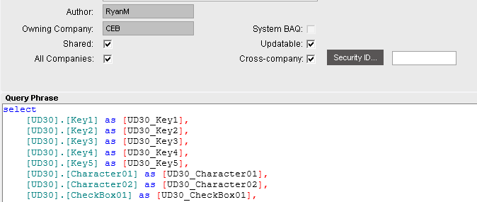

The data for each company needs to be updated by either company. Following the above advice I’ve set up a UBAQ that returns a single row from UD30:
The update for this UBAQ is Advanced BPM Update Only. My BPM looks like this:
