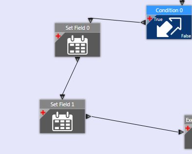

why not a BPM?
That way if the field is changes via a DMT you are still tracking the user data.
We do the same thing here.
An if condition to check to see if the field has changed.
Then a set field to set the custom id field to callContextClient.CurrentUserId
Then a set field to set the custom date field to BpmFunc.Now()
Capture
As a server geek, this always destroys me. So many people just think about one client and not all the other ways data can be sent to the server.
If you do an integration or use EWA or Mobile CRM, etc. Do you still want some piece of functionality to track this information? I would assume you don’t want an audit trail hole that you can drive a semi through. Use server code - a BPM.
