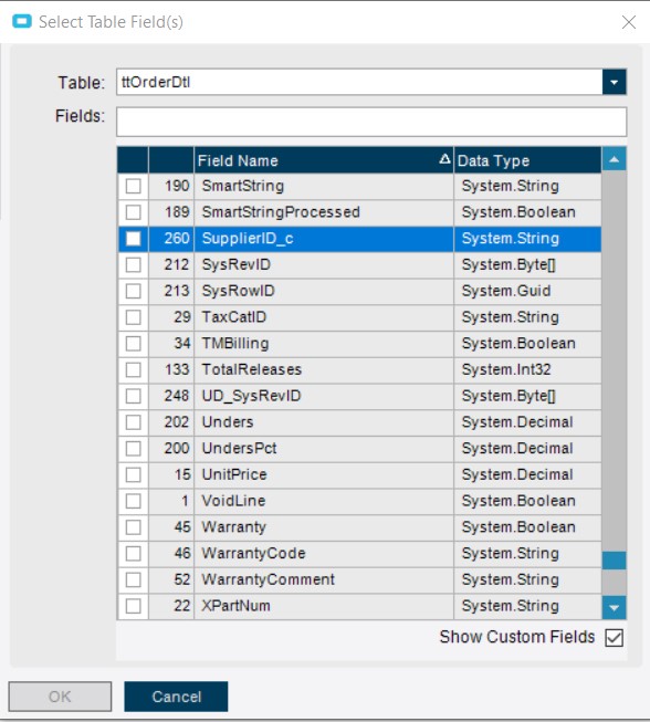

I am having an issue with two UD fields. I had created a field and realized I needed that field to be an integer instead of string. I then deleted that field, regen and reset IIS and then created the integer field, ,regen and reset IIS. The problem is that even though the first field is not longer synced to the database it is still showing up in the drop down for fields/Conditions/DataDirective and the new field is not there (deleted field = SupplierID_c, new field is VenNum_c)

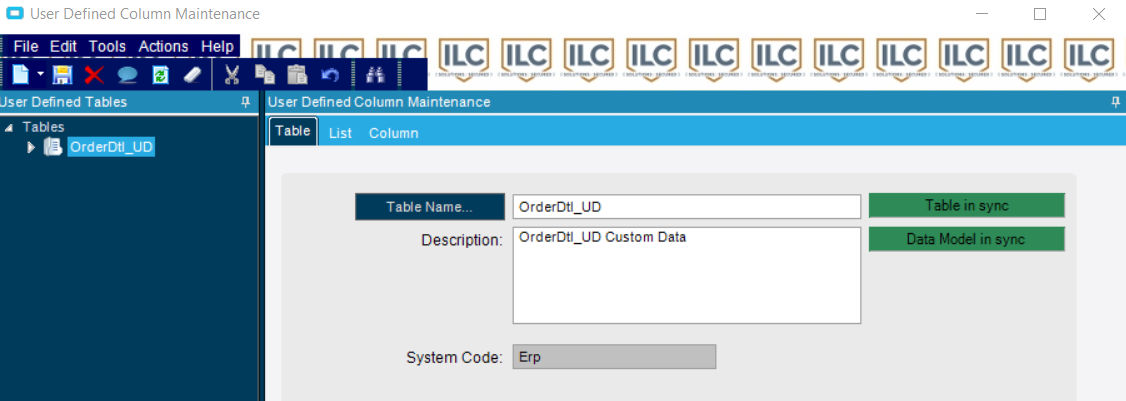

I verified the deleted field is not in Data Directory and the new field is:

When looking at the Extended Table it states it’s in sync:

I have followed all of the steps that were suggested and I am still having the problem. The only place this is not working properly is in Data Directives>Conditions>specified field.
