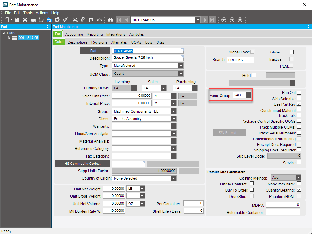

We added a new UD field to our Part menu.
I have that field as a column on a new version of our Stock Status report, but the data is not showing. What am I missing?

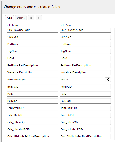

And the expression for the field containing the data on the report?
Did you add the field here?
Just PartAssociate in Field Name and Field Source should work.

Yes we have added it there.
Try making those (Field Name & Field Source) both PartAssoc.
I’ve never used different names.
We did already, but still same outcome. No data shows.
