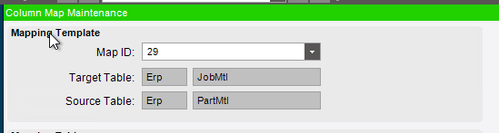

See below how we have it set up. This is for operations, but feel free to replace Opr with Mtl. For the ECO-Part relationship, you will need both directions (ECO-Part and Part-ECO).

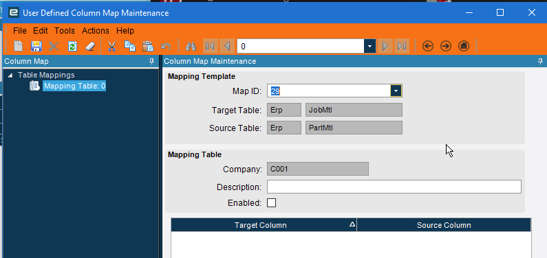

Can you show some screen shots of your setup? Maybe we can spot the problem. It should work.
Yes, that’s the one. So, when you bring in a revision into your Engineering workbench, that is source=PartMtl, target=ECOMtl. When you save the revision, it uses source=ECOMtl and target=PartMtl. When you create the job (with GetDetails from Actions) it uses source=PartMtl and target=JobMtl.

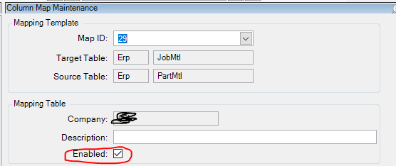

Well, it helps when you click the Enabled checkbox
