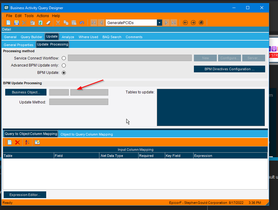

Are you trying to use the default update from the system? If you are, they you probably need to change the row mod of all the rows to “U” to get it tot pick it up. So do a loop and set the row mod in your loop. (I haven’t tested this, so I’m not 100% sure it will work).
The other option is to run you own Advanced BPM update and write your own code to the the update in a loop.

Would you mind sharing what you have currently? I typically just call the business objects I want to use to do the update or LINQ depending on what I’m updating. I don’t think it would work just setting the row mod of the results row to “U”.

we’ve seen thru the forum that it’s suggested to use the advanced BPM part of the update processing for the BAQ and to use the “Invoke BO Method” widget in the BPM, but what do you pass as the TableSet to that ?
(we would be using JobEntry BO, calling either Update or UpdateExt)
Do a trace in the UI, that will list all of the methods that are called. (It’s not just update) and you’ll have to call all (ok most… it takes some experience to understand what needs to be called) of the methods.
Usually it’s a getbyID which gets the dataset that you are trying to modify. Then you make your changes, then you set your row mod, then you call update.
