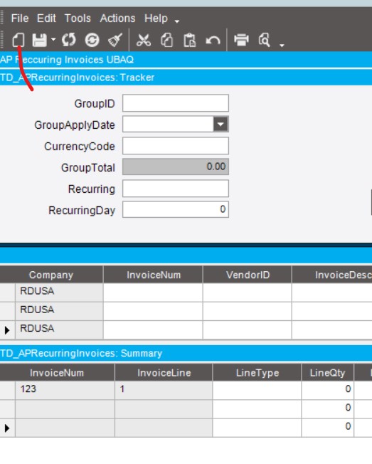

Is it possible to have an UBAQ on UD100/UD100A tables? If I put together a simple dashboard, I do not see any way to specify UD100 or UD100A from the “New” icon. Clicking “new” simply adds a new row to both tables.
I can make this into a singular UD table if there is no easy way to do with the Parent-Child tables.

You need a UBAQ for UD100 and another UBAQ for UD100A
then bring both of those into the same dashbaord In different panels.“Then clicking new” in the “right” panel will call the “right” getNew.
