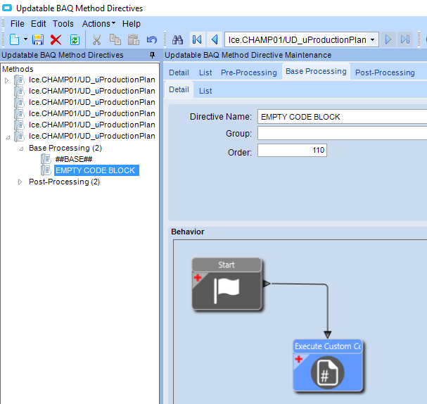

  1. I did as you said and added a BASE PROCESSING to the update method of this BAQ:
    The two Post-Processing Directives shown in the screenshot are disabled.

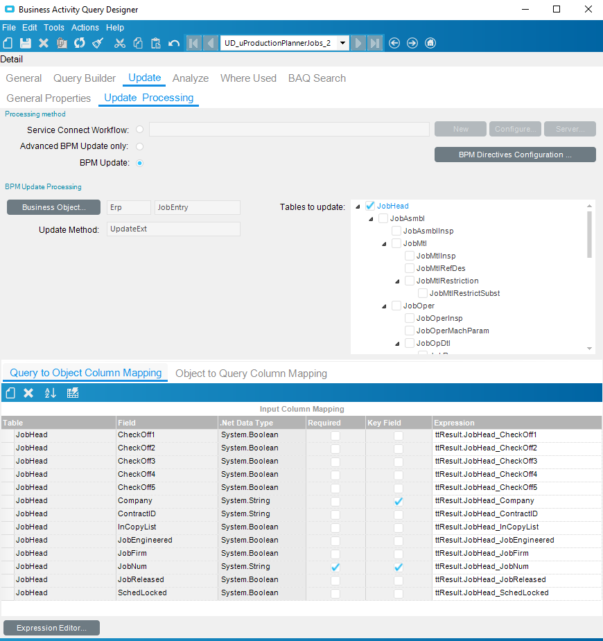

What does your update processing tab look like? If you aren’t using custom actions, then you probably don’t need to use BMP directives. In the BAQ, look at the Update > Update Processing tab. Whats that screen look like? You must have it setup right if it works in the BAQ.
Hey Nate,
Sure thing:
Object to Query Column Mapping:

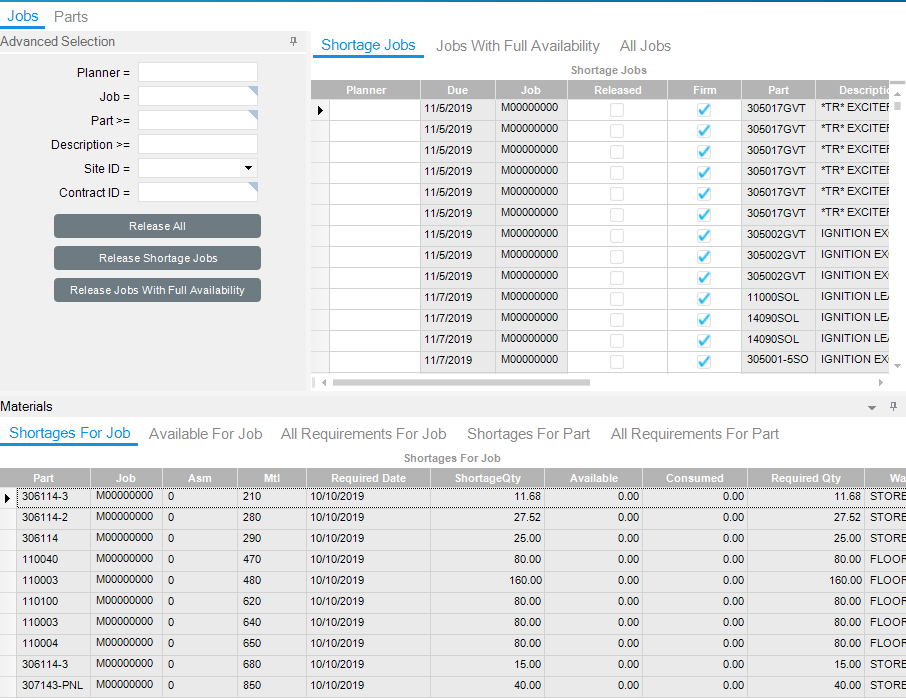

But in case it becomes relevant - the customization is really simple. On this dashboard there are 3 tabs which show All Jobs, Jobs with shortages, and jobs with full availability:
I’ve added three buttons which are visible in the above screenshot. These buttons just let a user check all visible jobs in a specific one of these tabs: “Release All” button marks each job displayed in the “All Jobs” tab as “Released”, “Release Shortage Jobs” does the same for the “Shortage Jobs” tab and so on.
The code behind to accomplish this is attached below:
