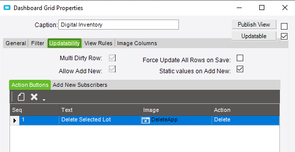

My dashboard is using this Action Buttons to trigger the Delete in the “Run Custom” in the UBAQ, FYI.

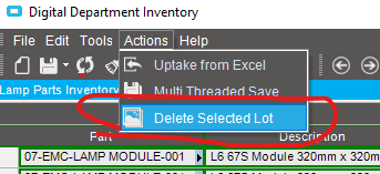

I put your code for Page Refresh under this event:
It works, but for every toolclick, not the specific one I am targeting.
Any idea how I can target the one I looking for?
It is from the “Action Buttons” I added.
I see what you are showing by adding an EpiButton and that custom code. I get that. I know you are showing me a solution.
I’m hoping to add to the action I have already trained on.

Now THAT is a good question. I have tried to link into the custom action on the menu, but I didn’t have any luck. I think that is why I went with my own button to execute the custom action, and then execute the refresh. I would love to hear anyone else’s solutions for this! Good luck!

So It look like you can get at the tool type with something like this:
	private void MainController_AfterToolClick(object sender, Ice.Lib.Framework.AfterToolClickEventArgs args)
	MessageBox.Show(args.Tool.Key.ToString());
This should show you the name of the tool you clicked on. You can then use that name to set your criteria. When I ran this, my custom action tool in the menu came up as “ViewButton1”. So I would set up something like this:
	if (args.Tool.Key.ToString() == "ViewButton1")
//Do refresh code
I am not sure about the timing of this. Not sure if the custom action will run before the refresh code, or after. If the custom action runs after the refresh then you may be stuck with making your own button.

My working code:
		if (args.Tool.Key.ToString() == "ViewButton1" )
			MainController.AppControlPanel.HandleToolClick("RefreshTool", new Infragistics.Win.UltraWinToolbars.ToolClickEventArgs(MainController.MainToolManager.Tools["RefreshTool"], null));
