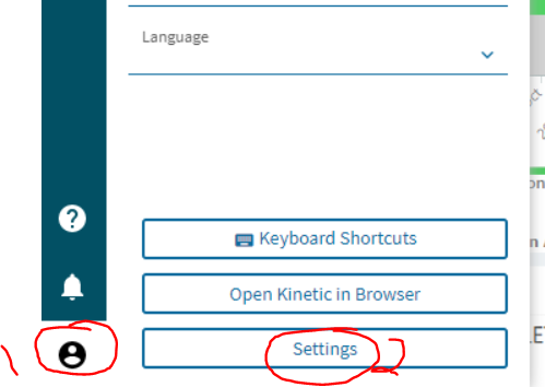

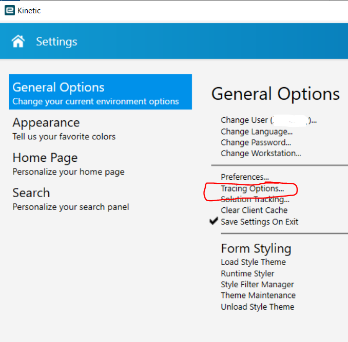

How does one turn on UI Tracking. I see a screen in a document that says 'Enable Trace Logging" under configuration settings. How do I get to the configuration settings on any form.

@mhussainib Welcome. As @BKen shows you can get there from Kinetic.
From Modern use this
Or this at the bottom of the screen.
With that being said, tracing isn’t going to show you classic customizations.
