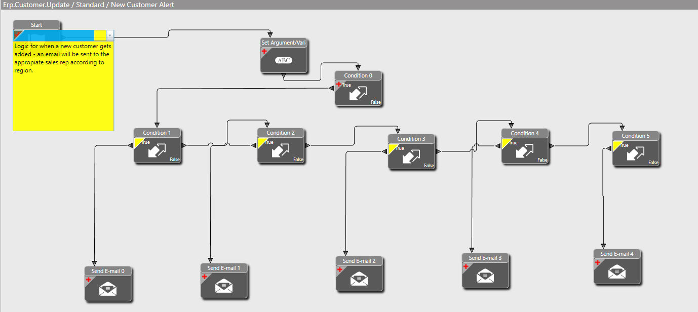

I created a quick BPM that sends an alert email out when a new customer gets added which will send an email out according to the territory to the appropriate sales rep. However when the finance team tries to post AR invoices - they get an error:
It’s common for the tt record to have more than one. Most of the time it’s an unchanged and changed record so that the system can compare for changes. Other times it’s actually updating more than one record. Try and add a message box into the BPM with field or table query in the message and see how many, and what rows are in the BPM. If there is more than one, you’ll probably have to loop. (which can’t be done easily with widgets)
I am setting var TerritoryID to ttCustomer.TerritoryID to route where the emails are going. I am unfamiliar with the GetCustomerTerritory method. Can you point me towards the right direction?
I don’t think you should need the “Set Argument/Variable” block at all. If you have the first block as a “There is at least one added row in the ttCustomer table” condition to evaluate for new customers (to differentiate between added, updated, deleted, etc.), you should be able to go right into the other conditions and email blocks.
I would also say you could optimize the other conditions, as long as sales reps are setup and linked to your territories (in other words, have a single action to send to the primary sales rep for the selected territory instead of multiple condition and send email blocks), but that is just personal preference and for easy of maintenance, not something that would prevent the directive from working.

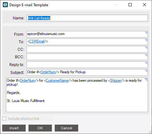

Here’s an example of a similar data directive that I have in place. This one emails the primary sales rep when a shipment with a specific ship via (Customer Pickup) is marked as “Shipped”, indicating that it’s ready to be picked up by the customer:
This just sets a custom variable that I created (CustomerName), since that field is not in the ShipHead dataset. This is simply so I can use that field in the email to the sales rep.
You probably won’t need this, since your data directive will be on the ttCustomer table, so it will already have the Customer Name and other relevant fields.
This sets another custom variable (CSMEmail) to the primary sales rep’s email address. It uses Linq to get the email address from the SalesRep table (joining through the Territory table, in my case). You would need something similar if you don’t want all of the various condition and email boxes. I will include the full text of the Linq query below, for reference:
(from Cust in Db.Customer
join Ter in Db.SalesTer on new {Cust.Company, Cust.TerritoryID} equals new {Ter.Company, Ter.TerritoryID}
join Rep in Db.SalesRep on new {Ter.Company, SalesRepCode = Ter.PrimeSalesRepCode} equals new {Rep.Company, Rep.SalesRepCode}
where Cust.Company == ttShipHeadRow.Company && Cust.CustNum == ttShipHeadRow.CustNum select Rep.EMailAddress).FirstOrDefault()
This uses the variables that were set in the last two blocks, as well as some fields from the ttShipHead dataset to send the email to the rep. Using this method allows one send email block to function for all the sales rep and doesn’t require hard-coding any emails or conditions for various territories/reps.
