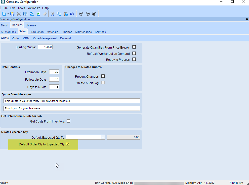

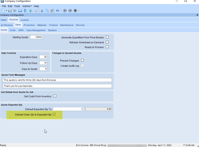

Our users say that the 3 quantity fields in Quote Entry (QuoteDt.OrderQty, QuoteDtl.SellingExpectedQty, QuoteQty.SellingQty) are always the same value for us. They put the quantity in all 3 fields, and if they forget, it causes an issue. I saw in Company Configuration that I could default the QuoteDtl.OrderQty value from the QuoteDtl.SellingExpectedQty, so I did that. That’s two out of three so far. Still need the third field to update.

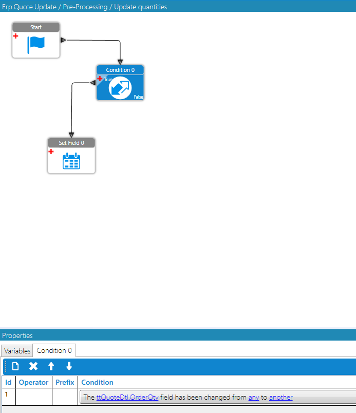

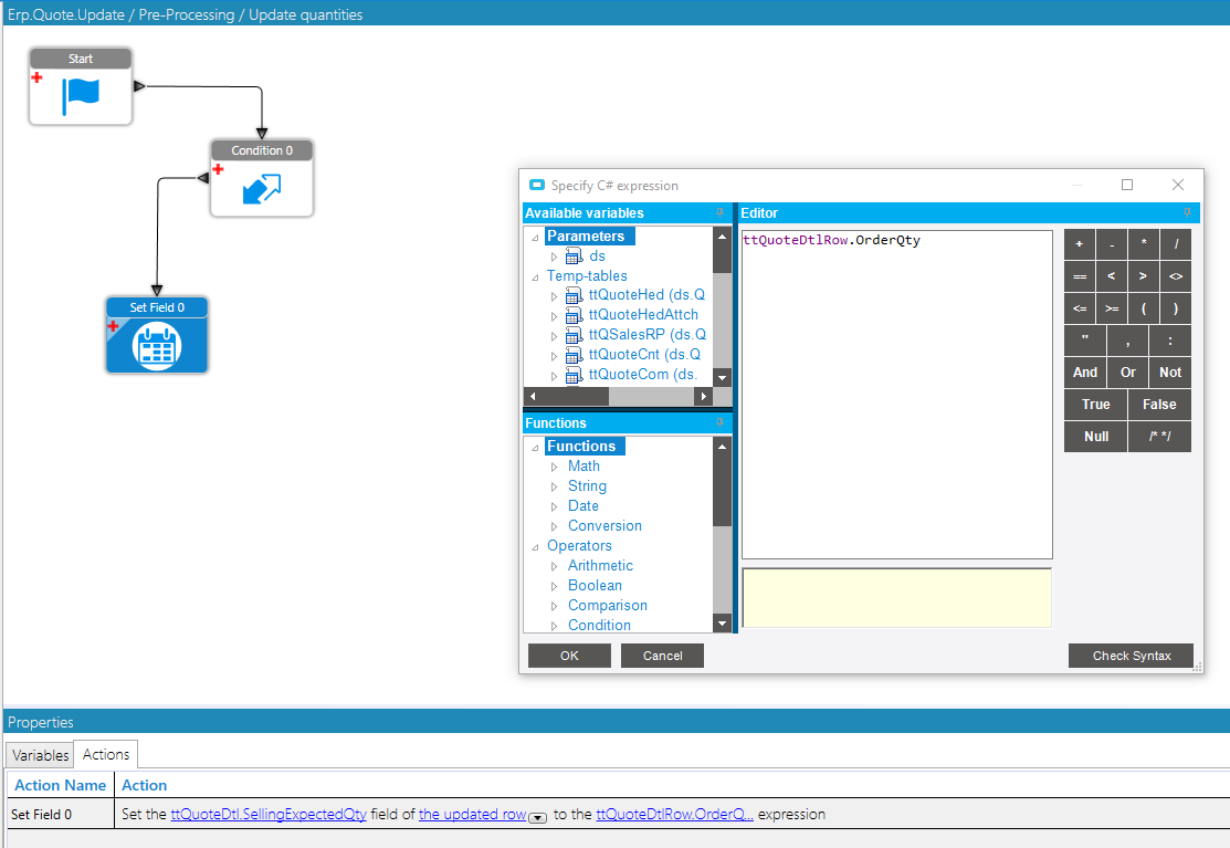

Admittedly, I’m not familiar with price breaks and how that interacts with the quote when you’re writing one up. I did a Pre-processing on Quote.Update and it updated the SellingExpectedQty when I updated the OrderQty field. However, it did not set the QuoteQty.SellingQty field. Is it supposed to? I take that it is supposed to indicate any quantities at which a price break occurs. If you change the quantity, you don’t necessarily want to affect the price break, do you?

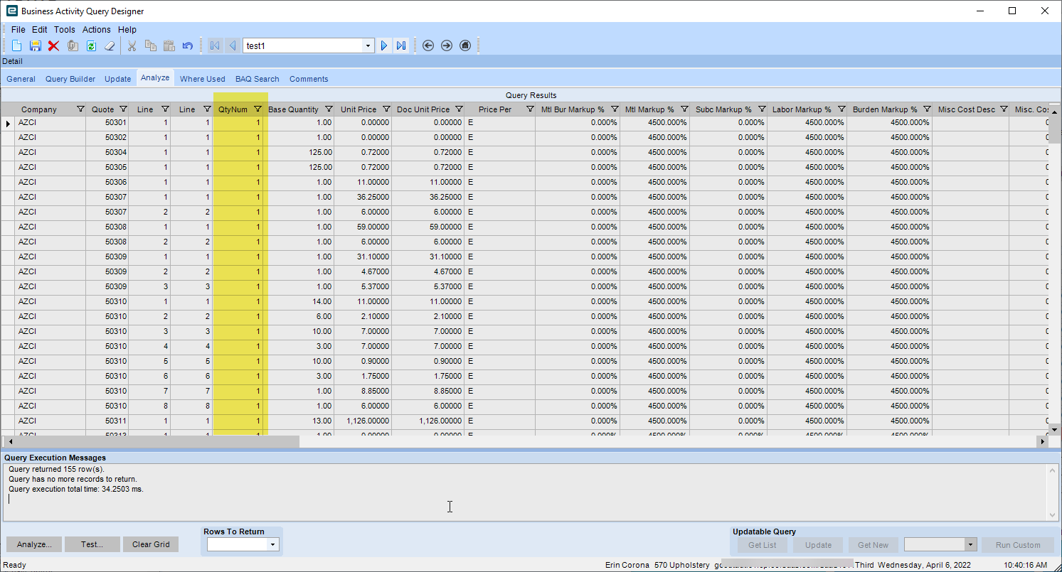

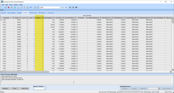

Thanks, @alintz. There’s also a QuoteQty.QtyNum that exists for each line, so it may be something to do with that. Looks like they start at 1 and can increment from there, but I ran a BAQ and all of mine are 1’s.

I wanted to circle back. One thing I have noticed is that if you enter the Expected Quantity first, the Order Quantity field updates to match it (I don’t think we have any kind of BPM in place… I think that’s just the base logic).

Our QuoteQty fields do default to 1, then users have to update the qty and the unit price. Honestly, it was just something we were going to do to make the 3 fields the same since they always are, apparently. If it wasn’t super difficult and time-consuming. But how hard is it to just enter the # in 2 spots? Not that hard. I have waaaay more important things on my to-do list lol. I had the fields highlighted after one holds a value, and turned on the above setting - I feel like that’s good enough for now. Haha. My executive decision right there.
