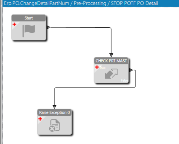

Oops, I normally include that in with a screenshot. Its a method directive, PO.Update, Pre-Processing
Okay I figured. In that case my above suggestion should still work. Let me know if you have issues!
Hmm. Trying to do to many things this morning. Ignore previous. PO ChangeDetailPartnum

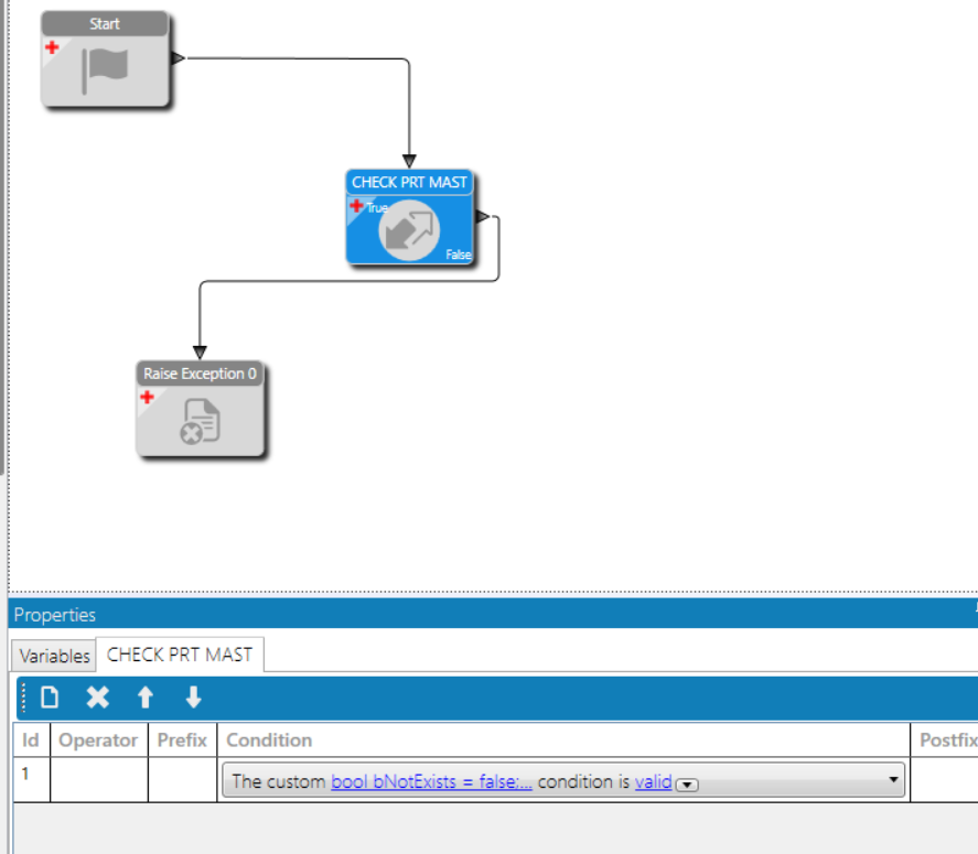

Can you show your condition widget logic? If it is still firing when the part number exists, it sounds like your condition is always returning false
Posted screenshot of logic. Thanks
