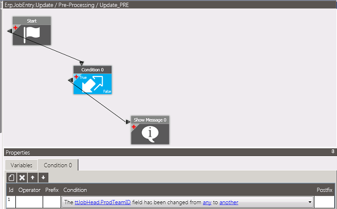

Trying to create a BPM that will send an email when user selects a certain ProdTeam ID in the Prod Team ID field,
I have tried to use both UPdate and ChangeJobHeadProdTeamID, Neither one of these seem to send an email.
Does anyone have any ideas?
I think you should be able to get a BPM for JobEntry.Update to work.
I might start with simple condition(s) and message, then add more conditions/email as needed.
e.g
Unfortunately that did not work either, just saved the job without any message popping up.
