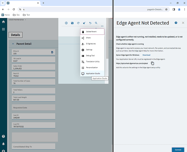

I encounter difficulty opening UD103 maintenance in Application Studio Editor via web browser. Error message reads “Edge Agent Not Detected.” However, accessing it from the same menu/Kinetic layer within Epicor’s Application Studio Editor works fine
Please advise on resolving this issue. See attached screenshot for reference.

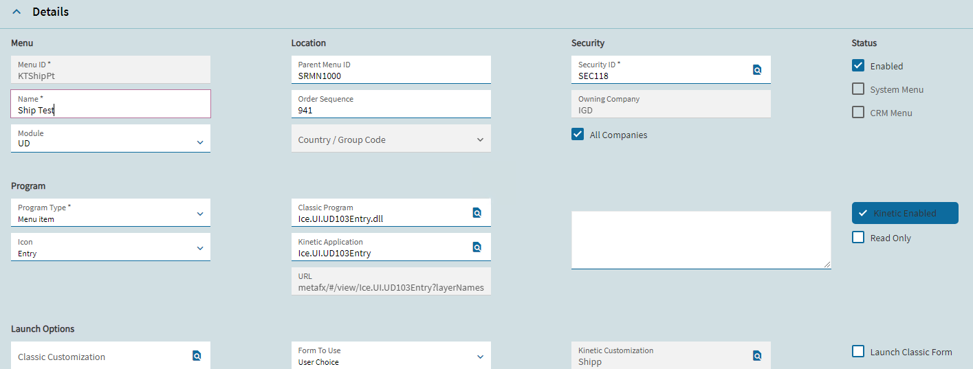

What’s your Menu Maint. set-up for this form?
Hello @dcamlin
Thank you for your feedback.
I found no issues with this; for your reference, a screenshot is provided below.
Consider whether you believe I should evaluate.
Menu Setup:

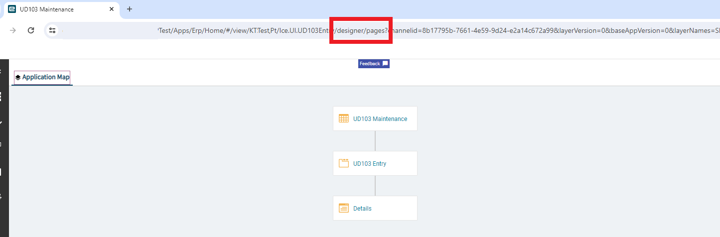

Although the problem is still present, a workaround has been discovered. When the Kinetic form is open in the web browser, the text “designer/pages” is appended to the URL, and the layer opens Application Studio.
