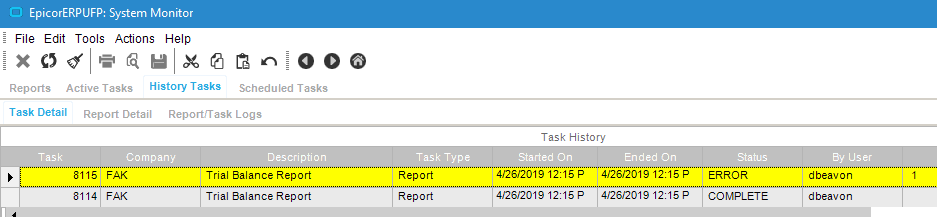

It crashes see below
If I submit for week 15 it works but week 5 crashes. I suspect it might be for some internal, technical reason. For example, I believe our GLPeriodBal table doesn’t have a week-zero in it yet for the year in question (whatever that might mean, it comes up in my search results).
Is a week zero necessary for running trial balances? Is there a way to get it added? Since week 5 predates the time we started on the ERP, I would expect the report to come back empty … but not to crash altogether.!

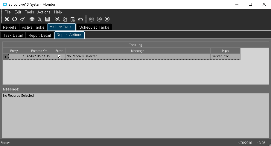

Having no records selected is an error that will cause to report to fail to run. Check for an error similar to below:
@asalvatore Yes I do see that same message in the third tab. Thanks for the pointer.
It says “No Record Selected”.
The same things happen if I filter a report on COA categories that aren’t present in a given week (ie. in a week that is otherwise working fine). It seems like the more preferred approach in this case would be to deliver a report that is empty rather than to crash altogether.
