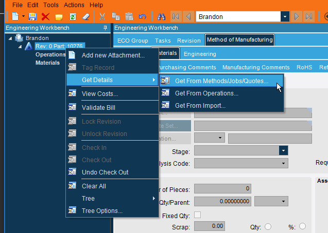

In engineering details, pick your job. It doesn’t matter if the parent part number doesn’t match.
What have you tried so far? (where are you getting stuck?)
Thank you that worked. I just added the job and the mom and bom came in.

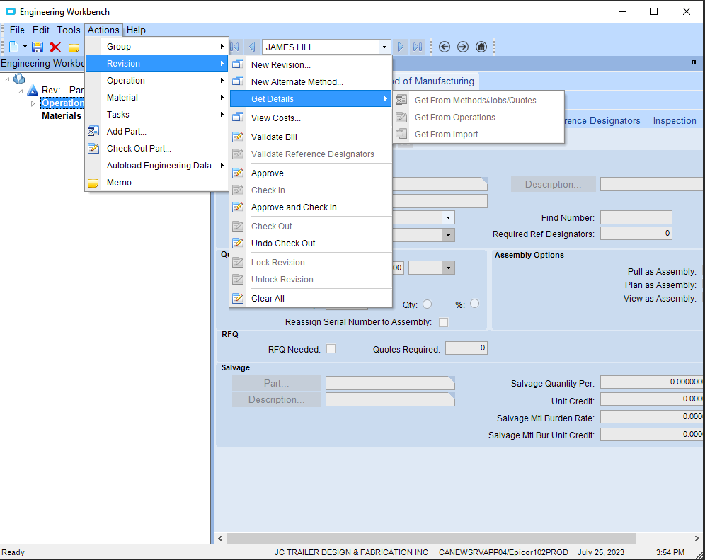

Hi I went to add a job (get details) to the part and it is grey out. Am I missing something that should be checked
You’re going to have to give us more information. “It” is not very specific, and I have no idea what you do or don’t have checked. Screenshots help a ton.
Sorry, I have attached a screen shot

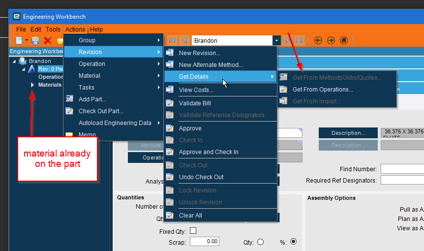

It’s because you already have operations on the part. In engineering workbench, you can’t keep adding methods like you can in the jobs.
Thanks,
I deleted the material and it worked.
