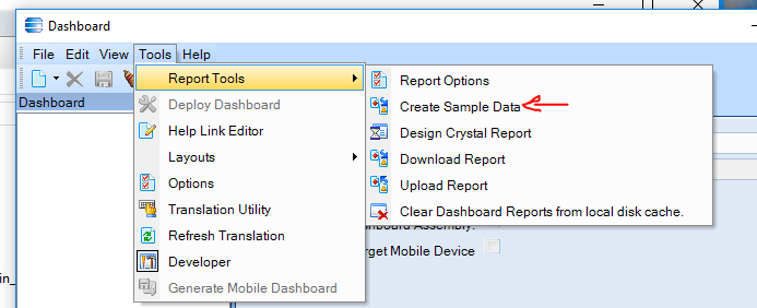

Yea I gave it a shot as well, and it didn’t work, I figured it would be a wild shot. I’m not talking about a BAQ report (which would work) I was suggesting adding a report to your dashboard. Open the dashbaord maintenance -> Tools ->Report tools -> Create sample data. Open crystal set that as a your data location, add a parameter for states so that you can select many. Save. Then add a new “report view” tab to your dashboard and make it the first tab. When the user loads the dashboard, they click on the “generate report” it prompts like a crystal report asking for parameters and they can select as many states as they want.
-Bobby.
