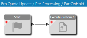

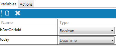

Hi Haso - You nailed it! I was able to get this to work using the your method, and even added checking the date (with a few struggles). Here’s the final result (if it helps anyone else).
2 Variables:
Execute Custom Code block:
