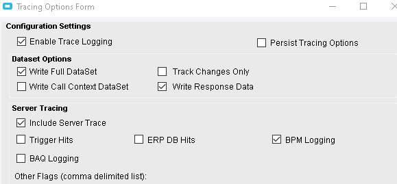

I’m trying to figure out where this part on hold pop-up message is generated (so I can get the same behavior in quote entry), but full trace logs don’t show anything… I click on ‘save’, MasterUpdate fires, but there don’t seem to be BPM’s that would generate this message. (note, the exception pops up when Part.OnHold=true).
The pop up’s exception shows that it’s on the SalesOrder.OrderDtlBeforeUpdate method, but I didn’t see this on any of our BPM’s (and couldn’t find this method anyways!)

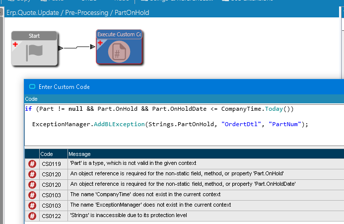

I tried adding that C# into Quote.Update / Pre, and get several errors. I’ll see if I can find the header info to put before the statement to declare everything (I think that’s what I need to do). Time for me to learn some C# baby steps :slight_smile:

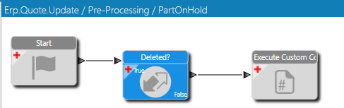

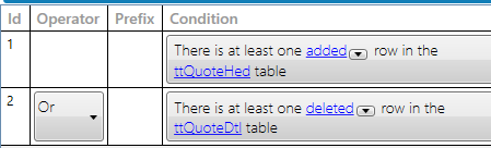

Whoops - Too fast. I had to add a conditional block before the C# code widget to let me delete a row. :slight_smile:
Then I also got an inner exception when creating a new quote - Non-static method requires a target. I need to check for nulls for the quote row, but not sure how, so I added another row to the condition to check for added rows in QuoteHed. Working so far in PILOT…
