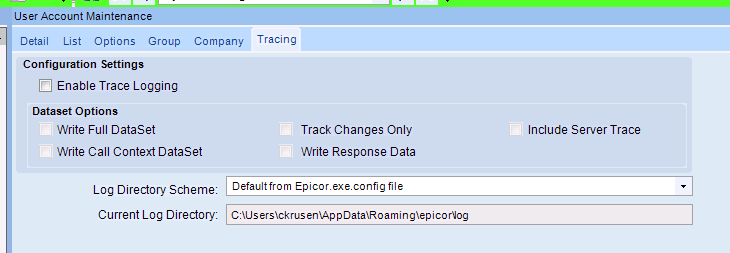

Is Tracing enabled for any users (under User Sec Maint)?
And what do the directories look like ?
I get this for my manager account
But these for a non-sec manager account
And it may even be specified at launch time, on a client-by-client basis
Default from Epicor.exe.config file – Select this option to use the path defined in the Epicor.exe.config file; this config file is located in the Client directory for each Epicor ERP installation. You enter the directory path and folder you want in the UITraceFileDefaultDirectory setting.
Edit: meant to include this
Tip: Users can override this default path on each client. When they display the Tracing Options Form on the client, they can enter a different path in the Current Log File field. The log files then generate in this folder and this custom directory path becomes the default Current Log Directory for this client. **
**However if the client can no longer find this location, the default path specified in the epicor.exe.config file is used instead. If the client cannot find this directory path location, the client then writes the client logs to the default %appdata%\epicor\log location; for example: C:\Users<ClientUserName>\AppData\Roaming\epicor\log

I’ve just come up against something rather odd when using the Demo system. If you login as Epicor, and perform a trace it picks up the path c:\users|. Then if you log onto another machine as a different user, login as Epicor and perform a trace, the path of the log file is remembered from the previous user. I was scratching my head as to why I was getting all these new users folders appearing in c:\users :slight_smile:
A bit of further investigation and looking at the Tracing setup for the Epicor user the Log Directory Scheme is set to Default from Epicor.exe.config file. Help says there should be a key named
“UITraceFileDefaultDirectory”. Looking at all the config file in the installed client there is no such key. The help says “When there is no path found then the traces are logged to User Account Maintenance-Tracing Fields
%appdata%\epicor\log”, which is what I am seeing, well what I though I was, but I suspect that it is acutally using Current Log Directory value instead, and that value is not updated until after you perform a trace. Needless to say the first time you perform a trace the trace directory is pointing to the c:\users folder of the last person that performed a trace!
So it appears there are two things here
  1. The key is missing from the config file.
  2. The Current Log Directory field for the user account is not being updated when the user logs in.

I didn’t end up logging a Case…I reread the Help… looks like it working as designed. Although, putting in the key into the config file seemed to have no effect …
