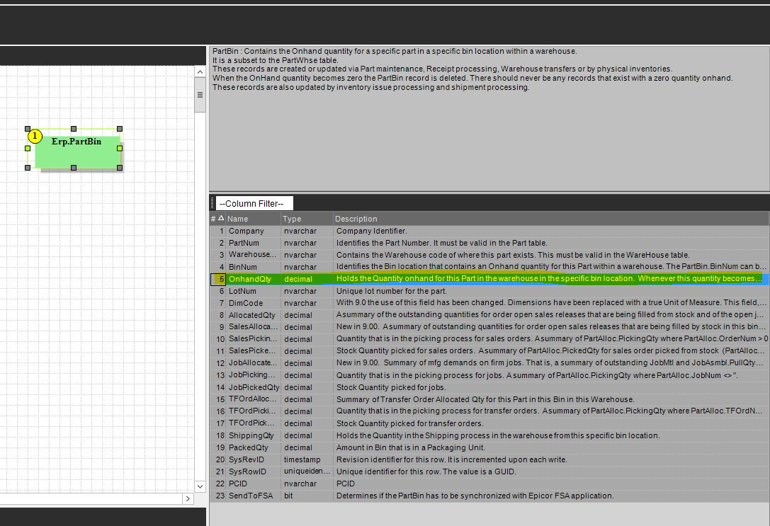

I know there is a field that has the total onhand for a part so I don’t have to calculate the sum but I cannot find the table.
Thanks in advance.
Thanks in advance.
There is not a value for the entire Site (Plant) but there is an onhand value for each warehouse (PartWhse). If you want to know the total available in your site, you will need to sum it up.
