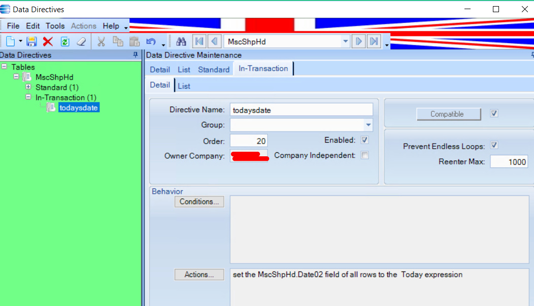

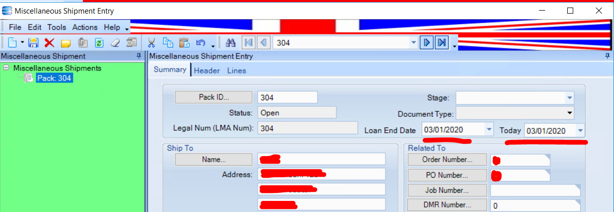

Task: i created 2 custom fields in miscellaneous shipment entry.
is a loan expiry date.
is today’s date
The idea is that when today’s date gets to the expiry date an email will fire to specific users updating them.
Problem: The email fires but the TODAY date doesn’t automatically update at midnight. The TODAY date only updates when the record is added/updated etc.
Once the record is saved to the database, it isn’t going to automatically change unless a user or process updates it. Using TODAY() as the method of populating the field is fine, but in reality to the DB it isn’t any different from a user having input a date.

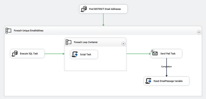

I have things that I want to check daily, and then trigger alerts. I do all of mine using SSIS (part of SQL Server) - that way I can have a SQL statement check for records matching a criteria, and then fire off an email to alert somebody. I do this for “Short Life Stock”, where the Expiry Date of a Lot is less than or equal to 10 days from today.

Yep all possible. If you’re doing any kind of update, then you want to use REST services and not SQL updates though. I’m happy using SQL, because I fully understand that I’m only ever doing it read only, and also caching in the appservers isn’t any issue.
I wouldn’t be looking to update anything using a process in your scenario, just flag to a user and let them do something about it. Make the SSIS package run daily at a set time, and then email results. Your current DD BPM relies on something triggering an update to the MscShpHd table, where the SSIS package is purely time schedule.
