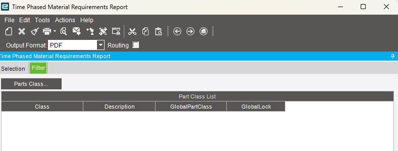

I am very lost with this customization task, I need to add a customized button in the Time Phased Mtl. Requirements. I need to add a customer search button that will filter out the report based off the selected customer. When I add the button, I am unable to bind it to the proper table, I also do not know what the proper table would be.
I looked up possible solutions for this and most said to use FKV for this. I am unable to find anything where it explains how to add the fkv.
Another issue I am having is, when I add a simple search to the button, I am trying to use the Customer Adapter but I am not seeing the proper table under data views. Could this be because I do not have the proper binding?

Oh sorry, I thought you meant time phased inquiry. I missed that you are talking about the report. You can’t add filters to standard reports.
I am trying to add a customization layer to the report, I thought it was something that could be done since my predecessor had done it to a couple reports.
You can only add filters on custom reports.

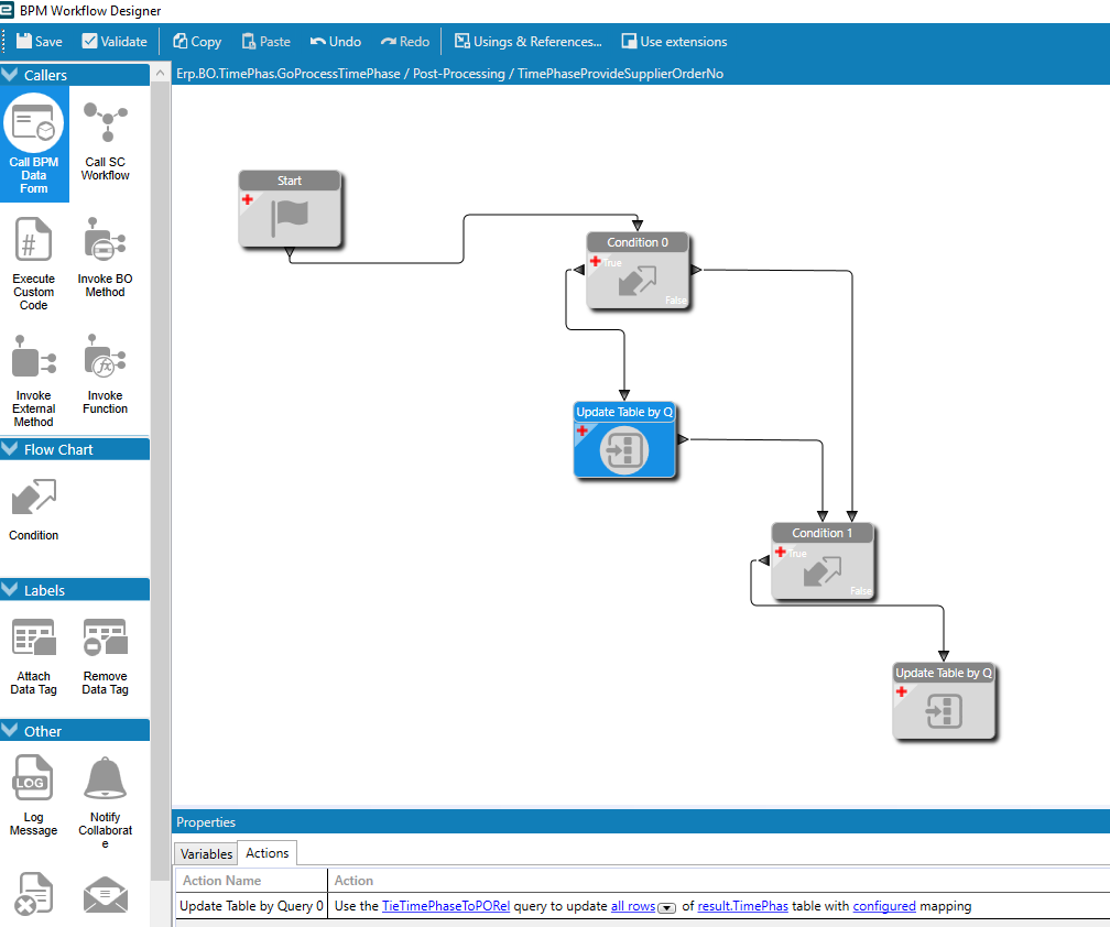

Hey Mark / Fiona,

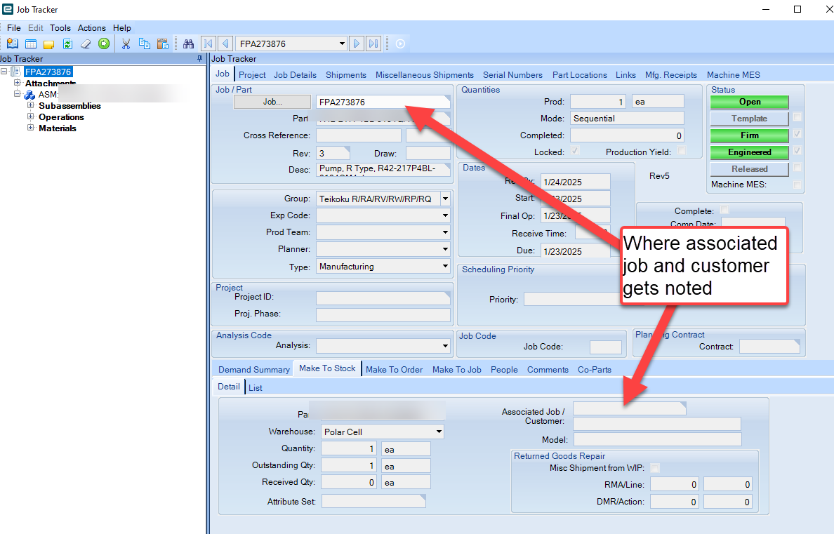

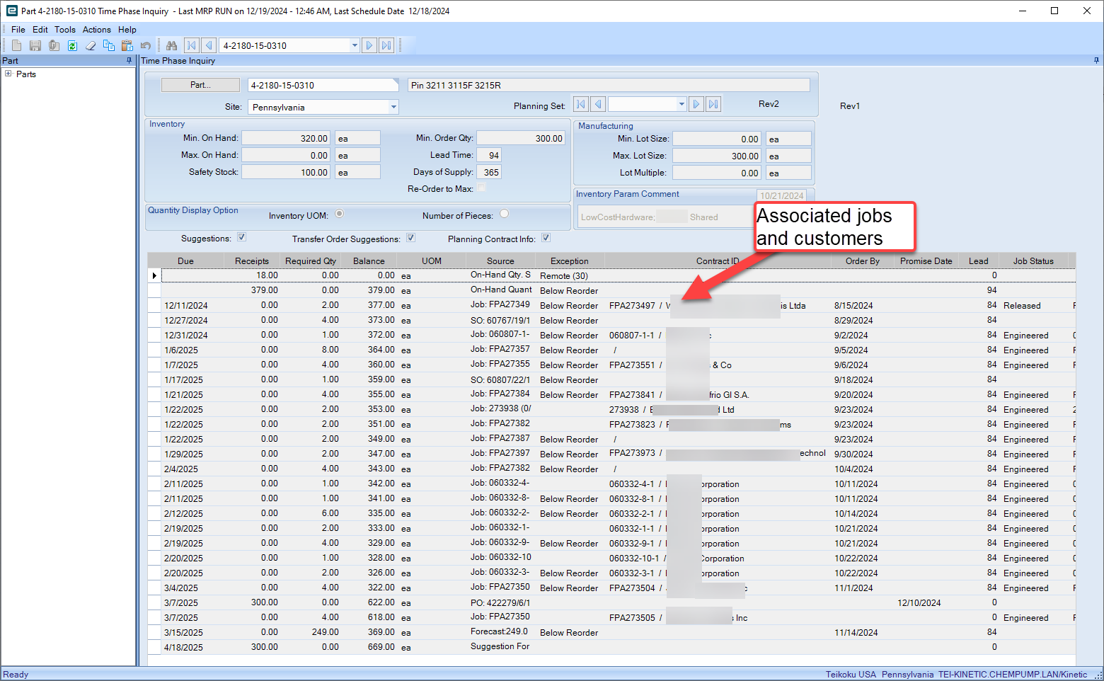

Yes, we do bind it on Go Process Timephase method. (thanks to some genius here, sorry been so long I don’t know who to thank now!). It has been one of our favorites here by many. We went down the path of noting what customer and job a part is for (we don’t do make to job much) on JobProd table data per below and then use this bpm to stick the data in the Contract ID field when timephase runs. It’s fast and has worked for years. I’m hoping that we never use Contract ID for what it’s meant for :rofl: and that it still works when we go to kinetic screens next year. :fearful:
Fiona, I’m not sure if this is the type of thing you’re looking for, since you mentioned the TP report. We don’t use the report.
HTH, Nancy
