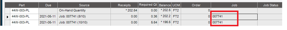

We have some issues on time phase showing deleted jobs.
Not sure what needs to done to make it disappear from time phase window?

Is part 44W-003-PL the finished good, or is it a material that was on job 007741? If it is a material, have your run MRP since deleting the job?
It is the material on the job that got deleted. Last MRP run was today and the job is showing.
Was the job deleted after the MRP last ran?
The job was deleted before the last MRP run… This job was created and deleted last year, just noticed this appeared today.
On time phase, there is usually a last ran date for MRP. Can you double check that as see what it says?

Record is not found when I try to enter that Job Number.
I will try to create a new record and delete it. See what happens.
I created a new job using that job number on a different part number and it gives this error.
Are you a multi site company?
Yes… I tried to open that job on other sites and created a baq to see if that job exist.
I see no record of it. It seems like its stuck in there for whatever reason.
