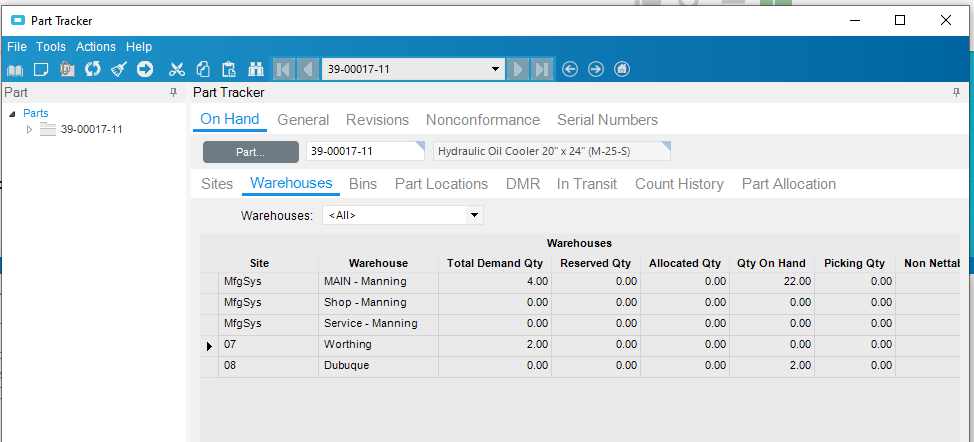

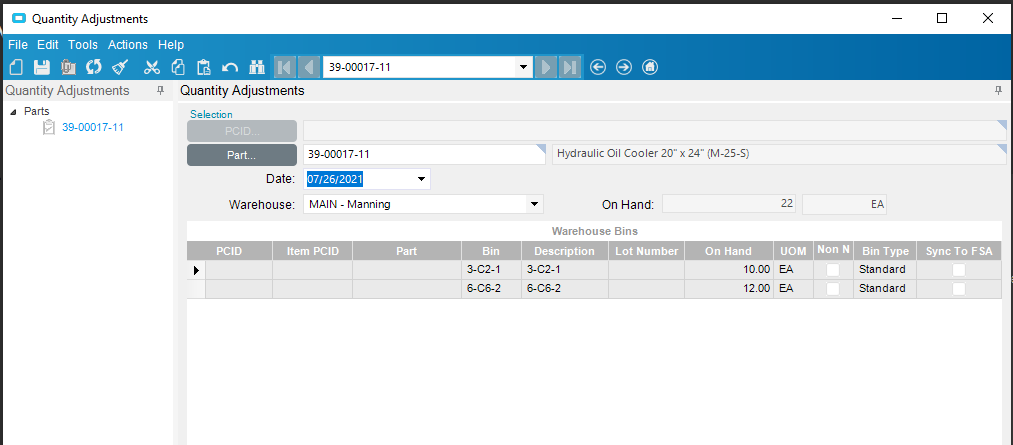

Has anyone ever experienced Time Phase not matching Part Transaction History Tracker/Quantity Adjustment? We found this afternoon a specific part that is showing incorrect on-hand qty for a part. On-hand Qty shown for one site is actually the on-hand qty for another. Also appears the Site tab under part tracker is also incorrect, but Warehouse and bin tabs are correct. I sort of remember there is a process you can run when part tracker doesn’t match quantity adjustment, but don’t remember what that is. Thoughts?
Time Phase - Incorrect
Part Tracker - Sites tab - Incorrect
Part Tracker - Warehouse Tab - Correct
Quantity Adjustment - Correct

Thanks! I ran that, it brought up some other parts mainly currently zero quantity ones. But, not the part in question.
I am not sure if this is the same as your screenshot shows Part Tracker and not Transaction History Tracker but we had an issue a couple of weeks ago where Time Phase didn’t match Transaction History Tracker and it was because someone had transacted for December 2021.
