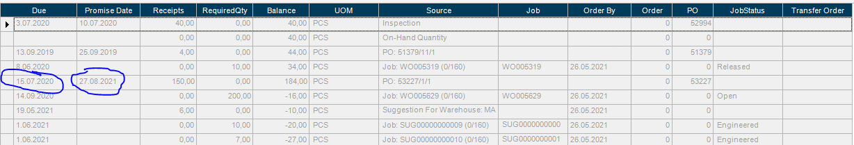

In our Purchase Order entry management, we enter PO and then the expected due date. Then supplier confirms it with a promise date. The purchasing specialist then updates the promise date on the purchase order which automatically updates the release promise date. But then in the time phase and material planning tools, Epicor still calculates based on the due date, not with promise dates. This creates a false view of material availability. I could not find any info in guides or manuals on how (or if at all) Epicor uses promise date. Is it a setting somewhere? How do the due date and promise date behave? Included a screenshot where:
PO53227 in delay had the due date 15.07.2020 but promised date was almost a year later on 27.08.2021, but the time phase still shows that it would arrive on 15.07.2020. Seems that promised date is not included anywhere is planning-wise useless. Which would updating the due date when the supplier confirms the due date.
