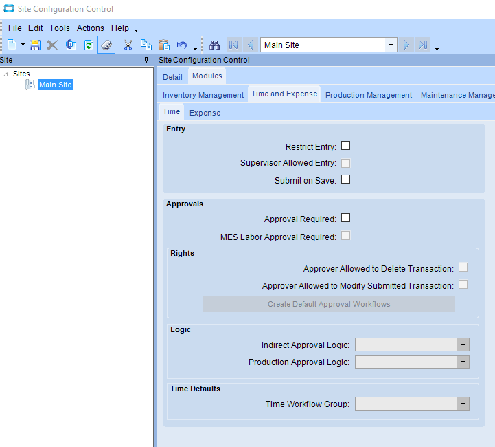

@sbang There is another setting you can check under Site Configuration. Go to Modules -> Time and Expense -> Time. The setting for “Restrict Entry” should fix this for you. Check the box if you want employees to only be able to enter time for themselves; leave unchecked to allow employees to enter time for any employee.

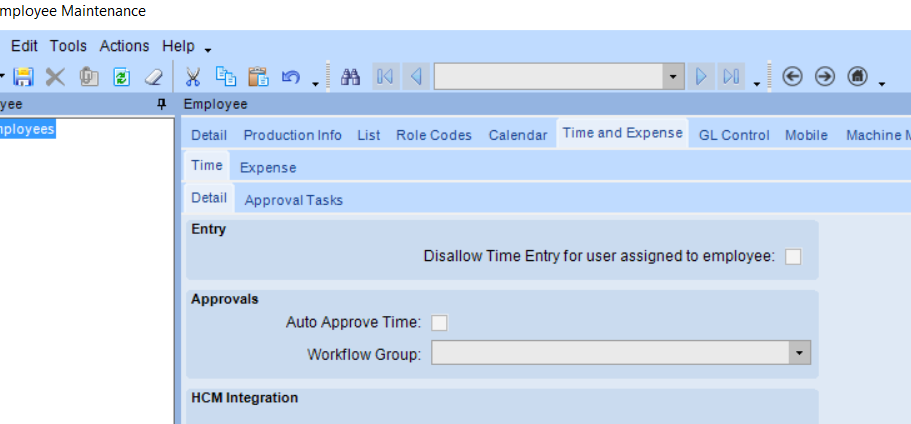

Hi Sydney, long time no see. Most likely the issue is that those emps arent linked to users. In order to limit in that method, this link will probably need to be made.

@sbang yes that’s definitely possible! That’s the exact set up I have at one of our companies. So if you have the Restrict Entry setting turned on in Site Configuration, you also need to make sure you set the Employee ID under each User. It’s under the company tab in user maintenance. I know that’ll default the employee ID for them in Time & Expense Entry, and I think it should give the access you’re looking for too.

In site configuration, Modules/ Time and expense/ Time, we have “Restrict Entry” as true but nothing else as true.
On user account security maintenance, we have a user set up with our company, with employee ID set up on the company tab with “can update time for all employees” as false.
And yet when we try to create a new time ticket for a specific employee user id, we cannot click new button.
Any other suggestions?
