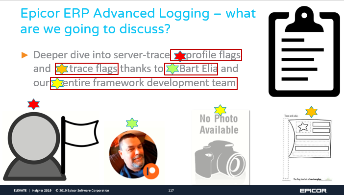

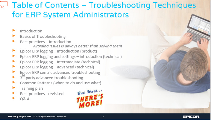

There are a number of labs and courses that discuss UI tracing to identify the BOs, methods and variables involved with a specific process including an Insights extended ed session that I just so happen to be involved with <cough>
They will make room for whoever signs up and wishes to attend. We dig into UI tracing in a few different ways in the session including some real-world examples (though, it is from the perspective of troubleshooting a problem where something doesn’t work–which is a little different than your project, but, the same tools/techniques are used). There are two additional slides with topics we cover after the one below, but, have to leave something to the imagination)
Slightly off topic:
Sneak peek at what we cover in the Epicor ERP logging - advanced (technical) section for those that wondered about server-tracing (which can also be used to get BOs, methods for specific processes)

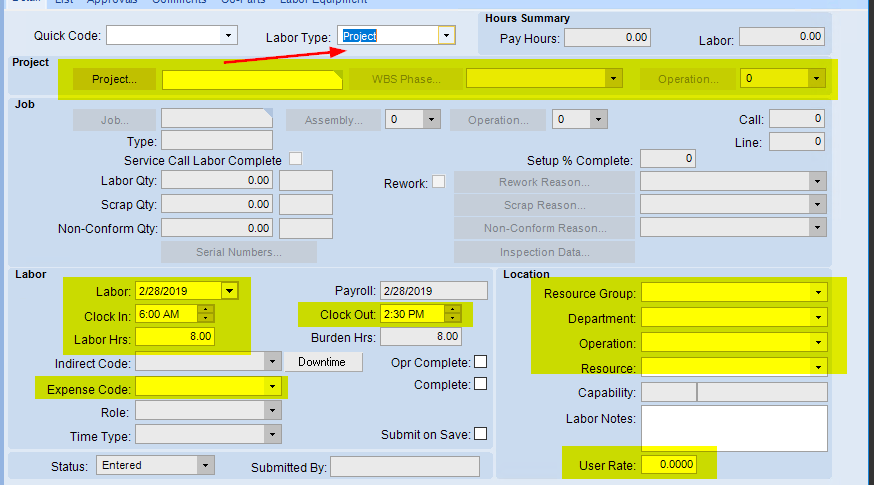

Hi Chris, do you have any hints on project based time entry and which fields are mandatory?
I’ve been stuck on this for a while, put it aside for the last 3 weeks to make progress elsewhere, but now I need to finish it off.
To close this off for now, I gave up. I tried to get this working for a long time, including the fields highlighted above but continually got generic error messages, and even had a support ticket with Epicor for over a month. Having a working solution took precedence, so I reverted to using the manual process of importing time entries via the DMT. Hopefully it doesn’t become too onerous.
