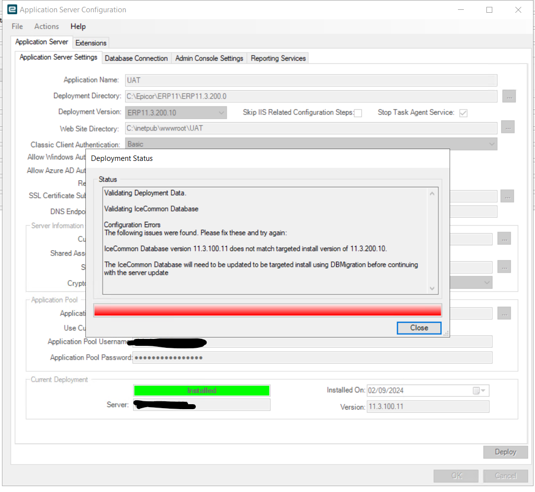

We successfully upgraded 1 out of 3 environments and has been running without issue and have since done an update patch to the latest version. We now need to upgrade another environment to the latest version making it 2 out of 3 running 2024.2 and the other still on 2024.1.
I’m reading through the documentation, skipping the installation step as this is already done (with the previous first install), the 2024.2 directory and installs exist. So I thought, it would just be a case of upgrading the database as per the below…

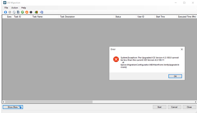

But when trying to do this, I get the below error, because it still sees the database as running 4.3.100.11 / 11.3.100.0

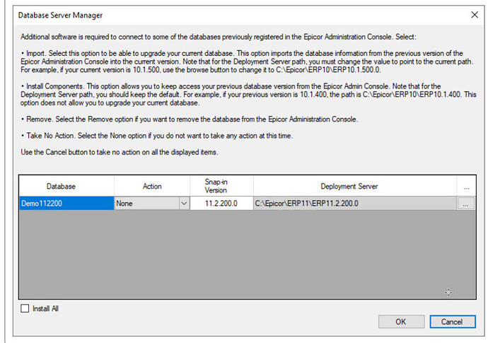

Looping back to my first upgrade (in the previous topic) when I originally got to this step of upgrading the admin console, I selected 2 out of the 3 environments as ‘Install Components’ so it didn’t upgrade and the 1 being upgraded as ‘Import’
When I check the application server config, I tried changing the deployment directory but it fails because the database upgrade portion hasn’t been done.

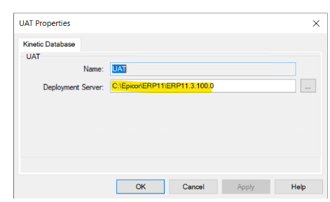

I’ve tried going to the database properties and changing the deployment path, but it just reverts back to ERP11.3.100.0 upon saving.
So I guess the issue I’m facing… is that I can’t find a way to get UAT to look at the new install directory so I can hit ‘Upgrade database’
Just wondering has anyone came across this please when installing across different versions/environments? Or I could definitely be missing a step? Unless maybe I need to go through the complete installation again rather than just trying to get UAT to point to the new version?
Many thanks in advance!!

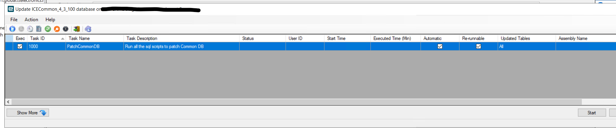

First thought: The error message says the common database is the problem. Did you try the Update Common Database option under Database Management?
I am sure there is a “cleaner” way to do this, but I have found that at times either the EAC or me get so confused that I can’t seem to get it to finally upgrade said environment.
Enter the nuclear option.
You can remove the db and/or the application server from the EAC (do not delete db in SQL!) and then use the register existing db/application server option to add them back in. At that point, I point them to the newest deployment folder and kick off said upgrades. This is an ugly approach, but I have done it out of a lack of other options in the past. I think the app server part is the really awful part so avoid that part if you can.
Thanks so much Chad! :slight_smile:

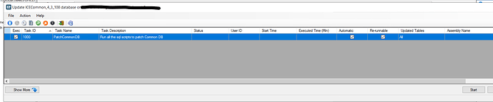

When I go to update common database, it asks me to select the snap in version, so I select 11.3.100.0
which then goes to the below
which when I did a release upgrade previously, there was a bunch more tasks to Execute here…

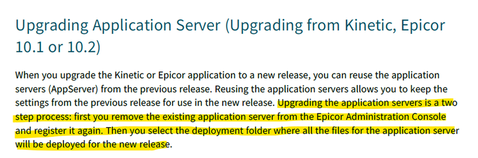

I saw this in the documentation in ref to an upgrade and wondered about removing/re-registering the app server, but was a bit hesitant to do it at first.
So far so good by removing db server and re-registering it, thanks so much!! :smiley: Just out of interest, were there a load of issues that you ran into when re-registering the app server?
