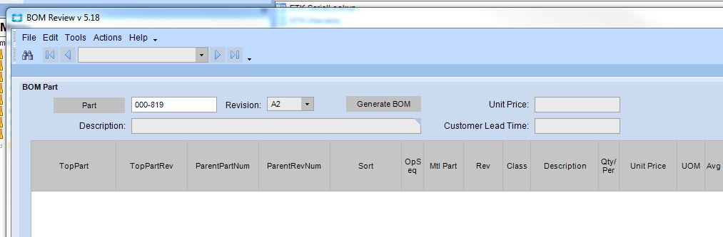

I have a custom form. There is a BAQ when you select a part. I know the results that the BAQ is returning
I want to connect the BAQ results to the text box fields below. I have them set the epiDataview Item. The EpiMagic is not working for me today.
I am asking please, and still no dice. Is there another magic word?
Forms looks like:

Maybe a dumb question, but have you tried refreshing the field itself after the data is bound to it?
I would do a refresh for each field? let me try that out.
That did not do it…
Well shoot. So, can you verify that the new epidataview has data in it as in you’re able to pull out values from it?
Now the revision combo is showing but not the other boxes. So I know there is data in the response.
			edv_BOMPartSummary.Row = 0;
			txtPartDescription.Refresh();
			cboRevisions.Refresh();
			txtUnitPrice.Refresh();
			txtCustLeadTime.Refresh();
My next idea will be to load the Revisions with all of the revisions from the BAQ. Then when the user selects a revision the row of the revision will show.
Have no idea what changed. Today it is working. crazy…
