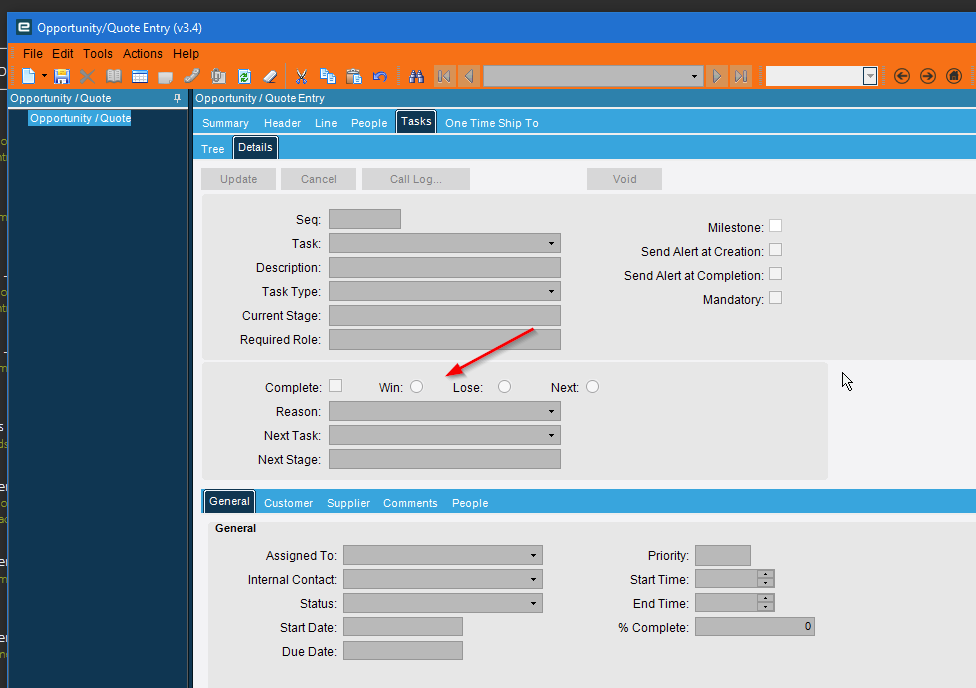

I am being told that they still are not able to mark a quote as Won or Lost with that checkbox checked, however if I add that user to the Authorized users of the Sales Rep in Work Force Maintenance, they can mark the quotes Won or Lost as expected.
The tasks work off of authorized user. And yes, it’s annoying. I don’t know of a way to make them be able to do all without adding the authorized user to all. At least you only have to do it once. (per workforce)

Setting the quote to won is in the task set.
