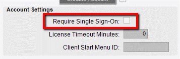

I think you are misunderstanding what Rich and I are trying to relate or I am not understanding how you are setup.
First, in User Account Maintenance there is a Require Single Sign-On check box. This does NOT need to be checked to use SSO, this just states that the user has
to use SSO to login, they could not use a Non-SSO App Server to log in.
