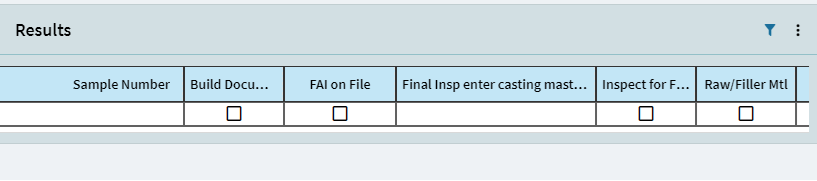

I believe they are dropping the legacy configurator all together and will start pushing the CPQ. Just my opinion based on Inspection Plans taking a gigantic step backwards with the loss of the configurator.
Inspection Plans lost the configurator?
In Kinetic they sure did. There are a few posts on here about it. Here is one of them.
Might be the best choice. The rest of the tooling has gotten so much better since Configurators first came into existence. Epicor functions are better than Configurator UD methods. BAQ’s are better than PC lookups.
Since they broke everything switching to Kinetic anyway, I think they should have simplified configurators to just be something that ties together these better technologies they have created instead of having separate, similar technologies.
