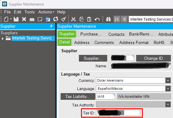

I need suggestions on the best approach for the following: I require that the Tax ID should not be duplicated; it must be unique. I need to know if I should handle this via BPM, Customization, or if there’s a simpler way to control this.
