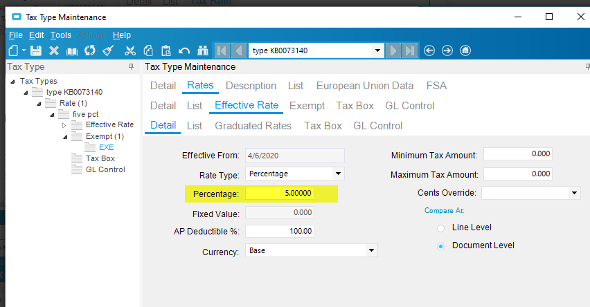

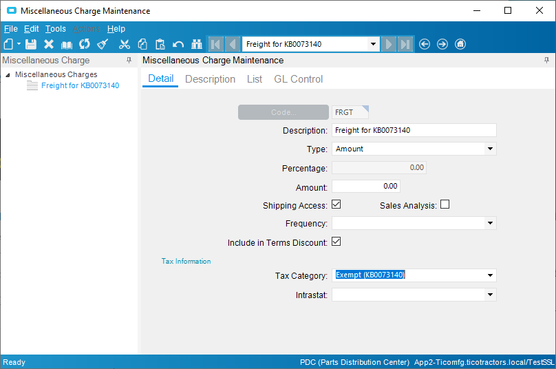

I followed KB0073140 on EpicCare*. It still applies taxes. (Expand for details)
Pics of setup
What am I missing?
*EDIT: As best I could. It assumes manifesting.
Why not just set the tax rate to 0%?
I can try it that way again. I tried it at zero the other day and it didn’t work. So I went back to 5% since I figured I was modifying the EpicCare article too much. They tell you to use 5%, so I did this time.

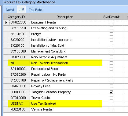

Looking at our Tax Categories, I see the following:
All the non-highlighted ones are used by Avalara (note the structured CatID). The two highlighted ones are ones we’ve manually entered. The NT one has no Tax Rates setup for it. So it calculates no tax.

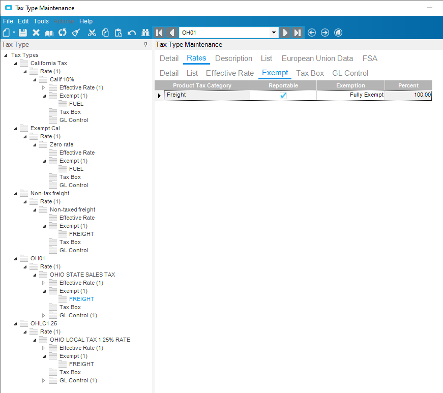

Support gave me a different article today, KB0052942, and it worked.
It seems the difference is that I have to add the freight exemption to every single Tax Type in order to exempt that specific tax.
OK that seems a bit extreme.
About to jump on a call about this.
Yep that’s it.
Every “Tax Type” you set up in Epicor has to include the Product Tax Category for tax-exempt freight if you want to exempt tax on freight in all localities. That’s what I was missing.
