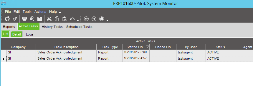

Tasks getting stuck?
We’re seeing a multiple tasks getting stuck as “Active” in the system monitor. Has anyone else seen anything like this?
Are these reports from an autoprint BPM?
Yes sir, they seem to be as the user is “taskagent” and that’s the user that runs the app server.
And, I imagine they are configured to autoprint to a server-side printer, correct?

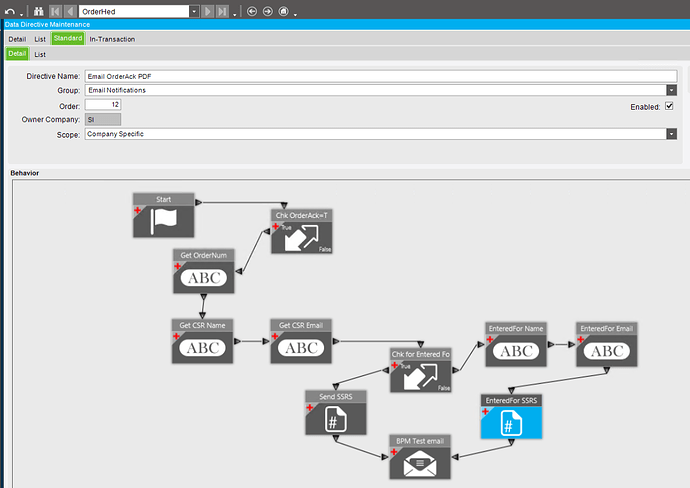

We have three auto-email BPMs on sales orders, but I tracked it to the the SSRS Print BPM I setup via another thread: BPM Method on SSRS Email (print) a Sales Order? - #24 by Randy - ERP 10 - Epicor User Help Forum
So probably something I missed.
I guess, it’s SSRS Email “print” job.
@Chris_Conn, I think @aidacra is going to make me beg. :wink:
Further investigate I’ve also discovered that this BPM also triggers the email send three times per BPM trigger, no matter how many lines on the SO or anything else I can find. It’s always three emails.
Now ironically, the “BPM Test email” node only emails once per BPM trigger. There is no loop in the C# code as I stripped the C# to the bare; Setting the variables in Set Argument/Variable nodes no IF or While statements in the code at all (code below screen shot)
Any ideas what I’m missing?

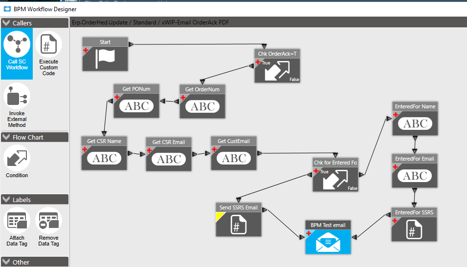

I’m not sure why it would be three times, but I found that saving a line on a sales order will trigger the data directive with two OrderHed records, one that has RowMod=“” and second with “U”. For checking this sort of thing I like to add a custom code at the start of the directive something like the following:
int RecordCnt = 0;
foreach (var MyOrderHed in (from OrderHedRecord in ttOrderHed /*where
RcvDtlRecord.RowMod == IceRow.ROWSTATE_ADDED */
select OrderHedRecord ))
this.PublishInfoMessage(" “+RecordCnt+” RowMod: “+MyOrderHed.RowMod+” OrderNum: “+MyOrderHed.OrderNum
, Ice.Common.BusinessObjectMessageType.Information
, Ice.Bpm.InfoMessageDisplayMode.Individual,”&q uot;“,”");
RecordCnt++;
Thanks @AndrewM, I’ll try that. Last night I moved the trigger logic to an In Transaction BPM but I’ll add this too.
@Randy @AndrewM @aidacra @Chris_Conn

Kinda lends credence to a permissions issue on some resource then. Maybe someone else here has a clue.
Could it be that the CSR email isnt set for her?
@Randy @Nathan_Woolen @Chris_Conn She can print it manually without any issues.
I will check her default printer, but I believe it would be the printer nearest to her desk which is what others have as their default printer and they are not having any issues.
@Chris_Conn I spent a lot of time yesterday trying to figure out if it was a permissions issue, but I gave her all the permissions in the world in Epicor and it didn’t do a thing. I also have printed the order using this customization and it works just fine.
