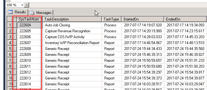

PID may have been the wrong term.
I was referring to the field called SysTaskNum within the Ice.SysTask table.
