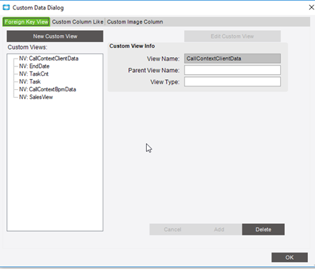

Try using the Foreign Key View (FKV) wizard under Data Tools. This will give better results without code. You may want to do this on HD Case as well.
Hi Thanks very much for your advice- I’m unsure how to use this FKV.

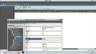

On the Customisation of Task List I can see this:
But unsure what to do
Many thanks

Ive been doing some reading up and I can see now how to add FKV’s thankyou
However I want to add this FKV to a grid that already exsits - the Task List grid. Just one column off the HDCase table.

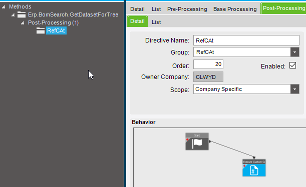

Can I ask one more? I have a similar requirement where I want to populate a RefCat_c (ud field) on Method tracker material list with the “Ref Category” from the Part record.
I tried manipulating your code and ended up with
/* add Ref Category to Method Tracker Material List*/
foreach (var ttPartMtl_xRow in ttPartMtl)
var ttPartMtlRow = ttPartMtl_xRow;
var Part = (from Part_Row in Db.Part
where Part_Row.PartNum == ttPartMtl_xRow.MtlPartNum
select Part_Row).FirstOrDefault();
if(Part != null);
ttPartMtl_xRow[“RefCat_c”] = Part.RefCategory;
I have added this code to
However the field isn’t populated. The UD Field RefCat_c is located on the Ecomtl table and I think this may be part of the problem, the method tracker binding Material List is EcoMtl hence why I added the ud field to this table.
I can see the ud field in the material list, but the code isn’t populating…

This looks like the records are put together for ECOMtl without exposing the method, so the post processing won’t work. You can use an FKV and get it on the material detail tab quickly
or dynamicquery adaptor would probably work here since you have the field on the grid. there are lots of posts on how to use and I think Jose Gomez made a video also.
Hi Greg
Thanks for advice. I originally began tacking this using FKV but I cant workout how you add an fkv field to a grid list which is based on EcoMtl
