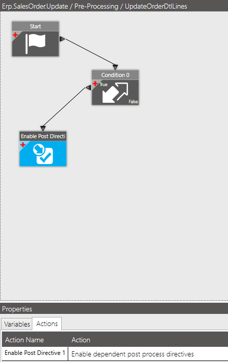

Here is the pre-processing BPM on Update method of SalesOrder.
I’m trying to set it up to call the following Post-Processing BPM:
This throws the following exception:
