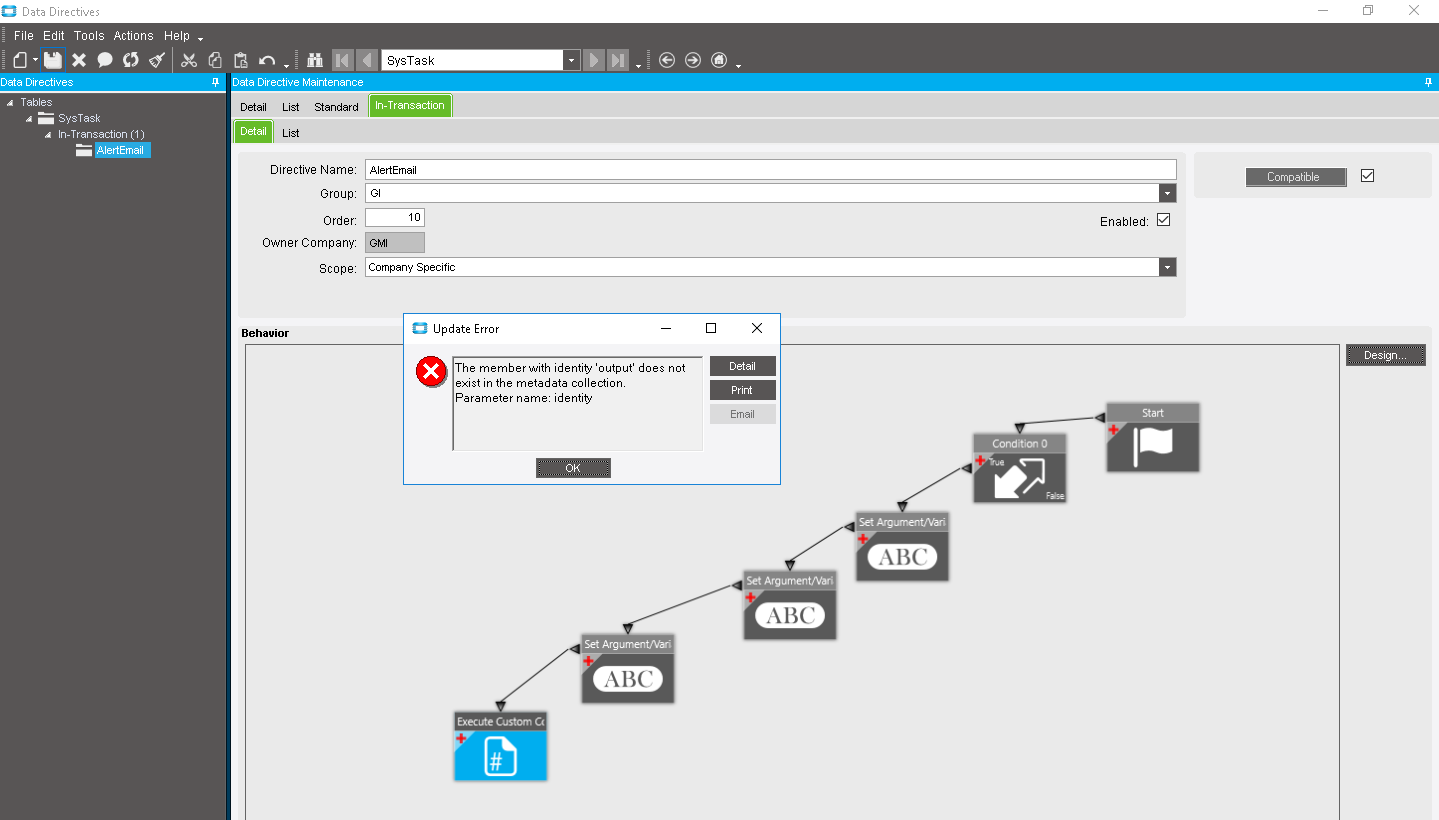

I am trying to Trigger BPM on SysTask Table. Whenever Process Finish it has to Trigger Email.I designed the Bpm but Problem is when I try to save it getting below mentioned Error.Could anyone help me out to resolve this issue?

Hi @Mohamed_Yusuff_S
is it possible to paste your C# code here? so people can see what are you trying to achieve ? also what are the parameters that you are trying to capture at this in-Tran stage ?
Hi @A.Baeisa
Thanks, dude I Resolved the Issue By Deleting the Trigger on Table Ice.BpDirective.
