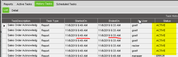

I’ve never seen a task have the Status “ACTIVE”. Anyone know what this is?
(FWIW - 10.1.400.23)

I have several users that are having problems printing. The System Monitor is still showing their last task as ACTIVE in the History tab. Nothing shows for them on the Active Tasks tab.
BTW - I didn’t think anything hit the history tab until it was complete.

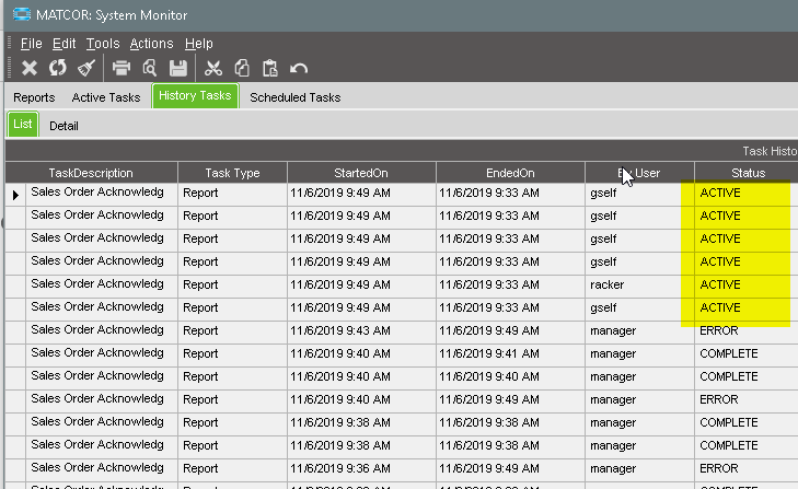

Also - The “Ended On” value is prior to the “Started On”, on these “ACTIVE” tasks
Okay … those ACTIVE tasks now show as ERROR, with the Error detail of
Program Ice.Services.Lib.RunTask raised an unexpected exception with the following message: RunTask: An error occurred within the report server database. This may be due to a connection failure, timeout or low disk condition within the database. ---> Microsoft.ReportingServices.Diagnostics.Utilities.ReportServerStorageException: An error occurred within the report server database. This may be due to a connection failure, timeout or low disk condition within the database. ---> System.Data.SqlClient.SqlException: Timeout expired. The timeout period elapsed prior to completion of the operation or the server is not responding.
