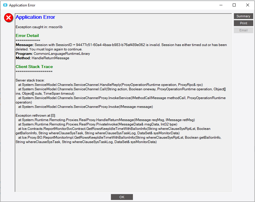

We use sysconfig shortcut files in a similar way to open specific records. We are having the same issue where sometimes the shortcut opens in the current session and sometimes it opens a new session.
I’ve done some testing and from what I can tell if the user has Epicor open with the classic menu or shell menu then the sysconfig shortcut opens using the current session (desired behavior). If they checked the kinetic home page box when logging in to Epicor then a sysconfig shortcut will always open a new session (not desired). If they are not allowed to have multiple sessions then they are kicked out of the original session when the new session opens (potential for data loss). Here’s the error that comes up when they get kicked out of the previous session:
