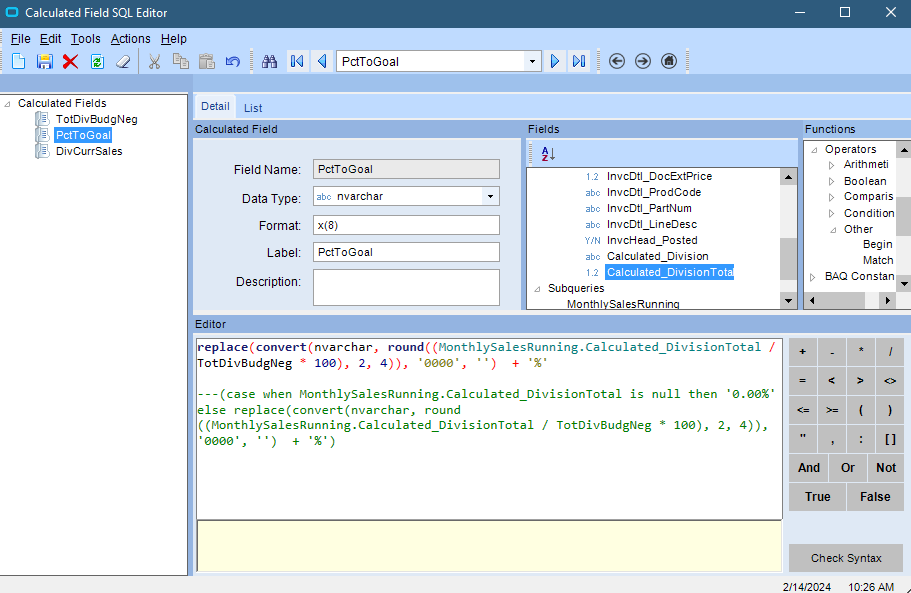

As the title says, I have a calculated field in a BAQ that I can’t quite find the right syntax for. Can someone tell me why the uncommented code in this screenshot works fine, but when I try to use it in a condition statement (the commented code), it errors out?

replace(convert(nvarchar, round((MonthlySalesRunning.Calculated_DivisionTotal / TotDivBudgNeg * 100), 2, 4)), '0000', '')  + '%'
---(case when MonthlySalesRunning.Calculated_DivisionTotal is null then '0.00%' else replace(convert(nvarchar, round((MonthlySalesRunning.Calculated_DivisionTotal / TotDivBudgNeg * 100), 2, 4)), '0000', '')  + '%')

Missing an END statement at the end.

change your data type to a decimal. then in format enter >>9.99%
That will automatically turn it into a percentage and then round to 2 decimal places. Or whatever you want.
OMG, it is that easy. Doh!
